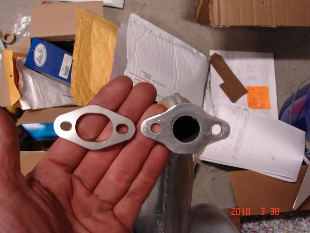

I have been using my manifolds on CNS and NT carb equipped engines. Cylinder porting is NOT necessary to make my manifold work. I ran one manifold with a ground open exhaust flange, the next couple with my full port weld on exhaust flange. So far I have not had to "re-tune" the engine for the manifold. It was a bolt on and go modification. I would agree that to realize the potential of any intake (mine included) the exhaust should also receive attention, but my intake manifold will fit in the stock location and will flow better than stock and that will help. I started with the exhaust first on my builds and then moved to improve the intake. I can include a full port exhaust flange for a couple extra bucks. You can use this flange as a guide to grind out (port) your existing exhaust flange. Bolt the new flange to the old as a guide and grind away, or better yet cut off the old exhaust flange and weld my version on. You will quickly find, though, the limits of how far you can port by the size of the pipe that is welded to the flange. I will try to post some pictures of typical exhaust port flanges. It's pretty funny when you see the difference.

Ya, I held up that exh. flange to my port and saw how much more I could potentially go out to....That`s my next project....

And more stuff on the way! Here is that picture I mentioned comparing the stock exhaust flange to a flange that matches the 80 cc cylinder. Port the intake and exhaust and it really opens these engines up. The exhaust flange is 10 gauge laser cut stainless and adds $5 to a manifold order.
