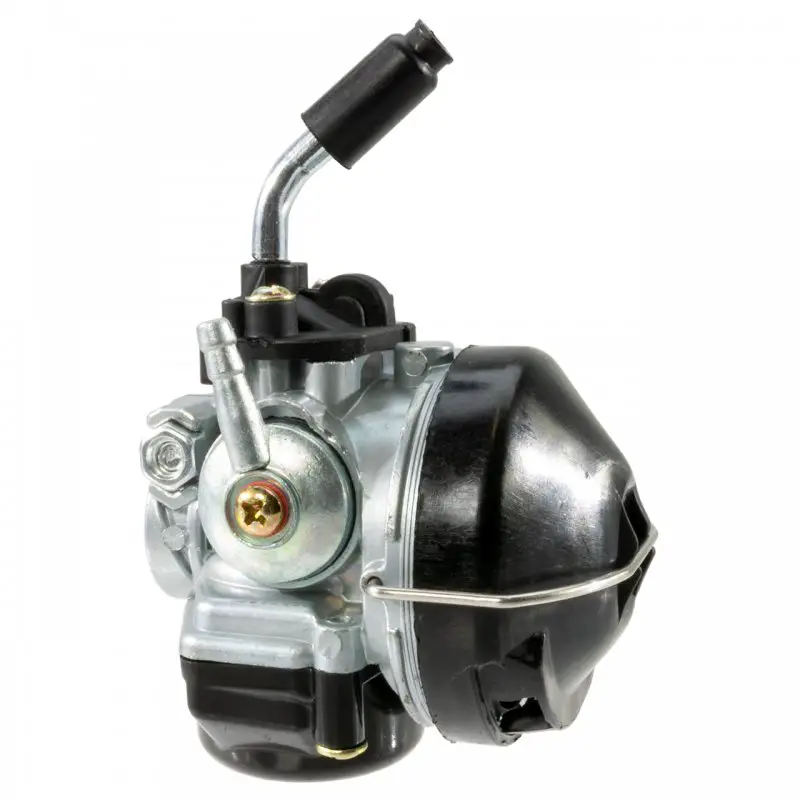

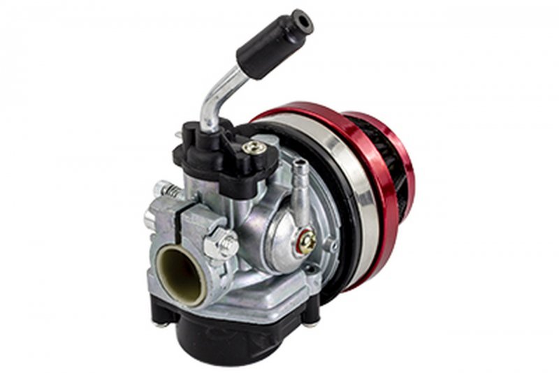

It is called a couple of different names. Most commonly it is called a Dellorto SHA Carburetor clone 15/15. I have attached a couple of pictures. Almost every website that sells motorized bike parts carry them.
I think they are easier to tune than the stock NT carbs.

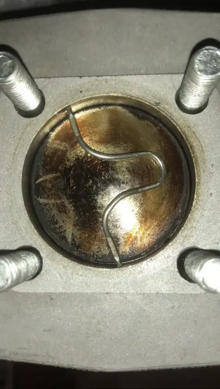

So I tried to measure the squish using 1.25mm/0.062” rosin core solder and the solder didn’t even come in contact with the head. The first time I did it I forgot to put the head gasket on and it squashed the solder. I’m guessing this means my squish is too big?
