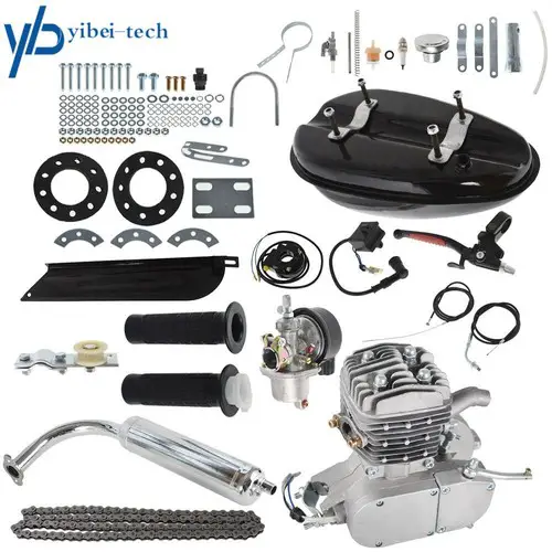

People often justify paying a $100 markup for "better XYZ," falling for the same propaganda companies like CMB have used for years. They claim their products are superior, but the "new features" like 4-bolt tensioners and socket cap hardware are standard now. You’d have to go out of your way to find a kit without those features.
Some claim they recently bought kits with outdated specs like flathead hardware or a 32mm intake, but that's just not true unless they found old stock. Check eBay for the cheapest two-piece cylinder engines—there are only four or five factories left. Avoid Amazon, as brands like IMAYCC or Seeutuk are just generic kits with branded clutch covers.
People insist certain companies, like BikeBerry, offer higher quality, but there's no proof—just subjective claims. When I bought engines, I chose the cheapest two-piece kits on eBay, and I’ve had engines last from 150 to 2,400 miles. Any failures were due to mistakes I made, not product flaws.
Engine #1 - Lasted 150 miles because I setup the clutch so poorly (To readers, how the camshaft rotates onto the bucking bar when the clutch is disengaged, I actually pushed the clutch arm inwards and set it up that way, I didn't know how to fix it so I gave up)
Engine #2 - 1,200 miles (Retired but worked well, wanted to learn how to split a case)
Engine #3 - 2,400 miles (Retired after building an MS440)
I would suggest the kit in the link below. People only like Amazon because if they destroy the engine because they lack basic mechanic and tool understanding they can return it.

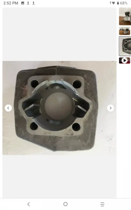

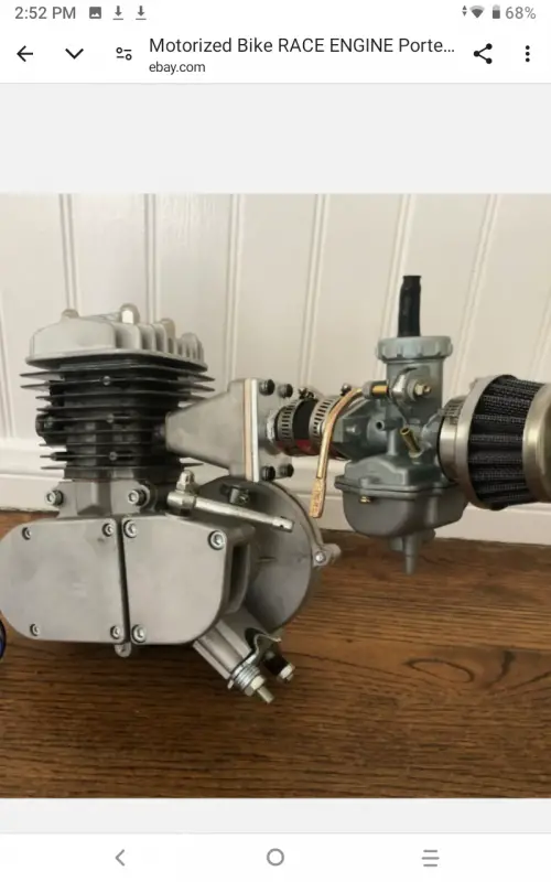

Bicycle-engines.com has a 6 month warranty. I like doing business with them. I have heard good and bad of the 49mm iron bore from eBay. I hear they have potential soft seize issues, and to improve the port timing just use a Dremel and match the sleeve to the ports. BBR has decent engines, but don't fall for the "stage 4 racing" crap. I personally love my phantom 85, but that's not an engine for someone just getting into this hobby.

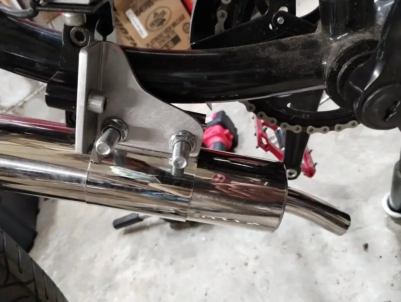

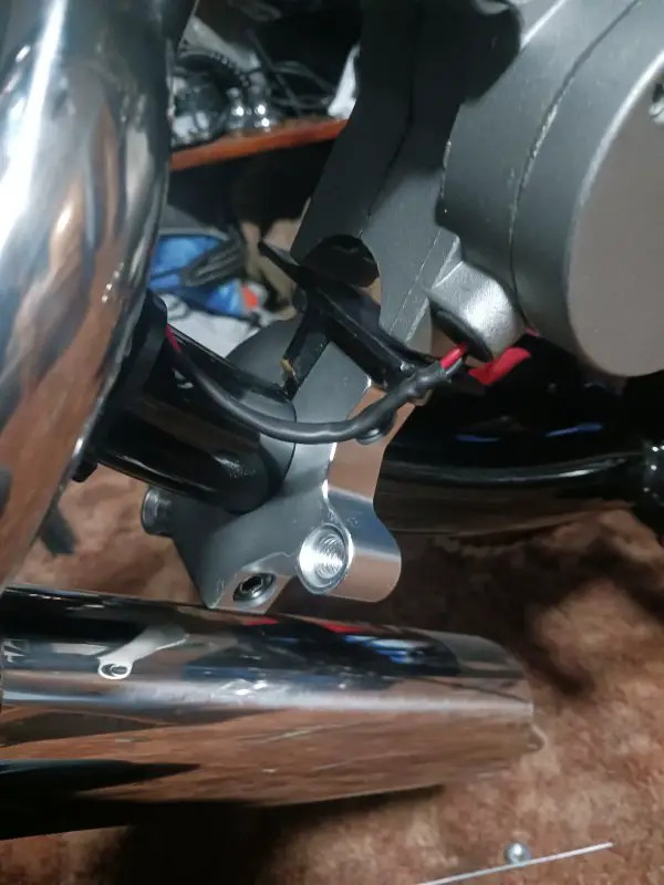

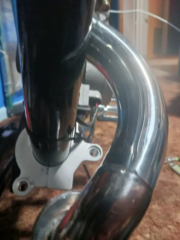

I made my own version of this with an old hub adapter so I had a bolt hole for an exhaust hanger...

Sproket addapter KOOL..........Curt
Yeah, I was too cheap to order the CDH and had a sprocket adapter laying around. Figured I would take some of the angle iron I had and braze it together with some holes to mount to the engine. I ended up painting it black and making an exhaust hanger off it...
