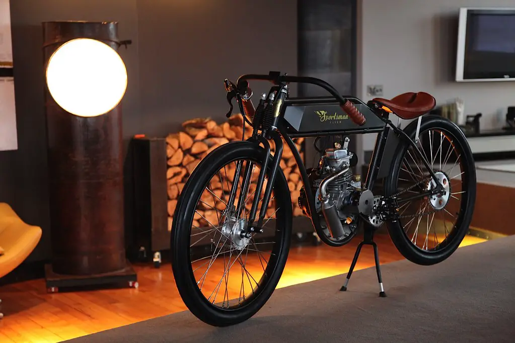

Thanks for posting that picture - I never seem to have luck posting photos in these forums.
I'm amazed at the fit and finish of this Sportsman 80 - it was a dream assembling this bike. I am very impressed with the way the sprocket adapter fits the back hub, and how carefully thought out the engine mounts are. How about that seat!!!?? I stretched the assembly over 3 nights because it was so much fun! I don't know if I should ride it, or hang it on my wall.
I WISHED it wasn't 20 degrees outside... I'm DYING to start this thing up and take it for a spin.
If anyone is considering a sportsman, TRUST ME, you won't be disappointed. It really doesn't get any better than this! Pat has an excellent thing going - he really knows his stuff, and provided incredible support during the whole build.
Thanks for everything Pat! I still have my eye on that Bonnie...
