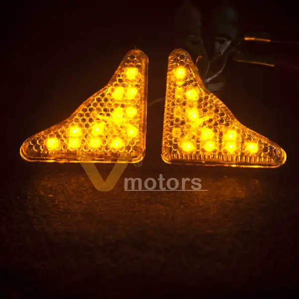

I think I have a bunch of 3.7v 18650 batteries to use and a dc motor. just need to figure out how to wire so it can do blinkers and stuff
might need one of theses
