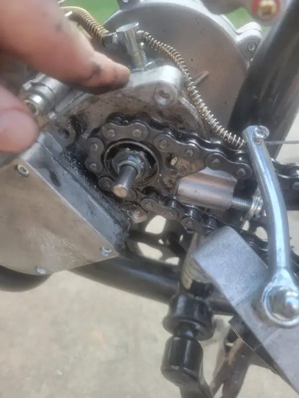

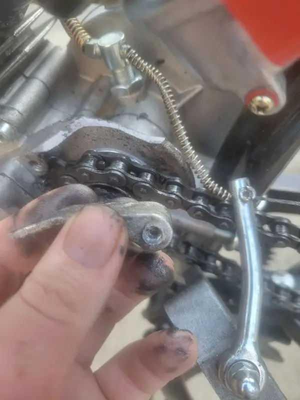

D Deadmob87 New Member Oct 7, 2023 #1 Will jb weld fix this or what is my best solution Attachments 20230928_180023.jpg 68.8 KB · Views: 352 20230928_175956.jpg 72 KB · Views: 366

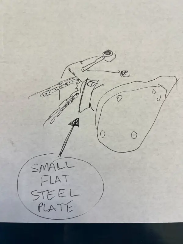

Venice Motor Bikes Custom Builder / Dealer/Los Angeles Oct 7, 2023 #2 Nope... JB won't fix it... But there's an easy fix! Put it all back together & bolt a small piece of flat steel on the back side that will support it from flexing when you pull the clutch. Here's a cheesy drawing (looking from the backside).
