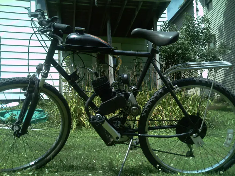

The kit came in a few days ago, and I put it together. Of course, I messed up. I put the big sprocket on the inside of the freewheel, not the outside. This caused a bunch of other problems. I contacted Jim at SBP, and he's sorting me out. Since the bearing mount plate bent(my fault) he's even sending me a new one! By the rally(Hopefully i go) it should be ready.
A shifter kit is another thing I have been considering to give more power for hills, etc, but I think I may get a 4 stroke kit instead.
