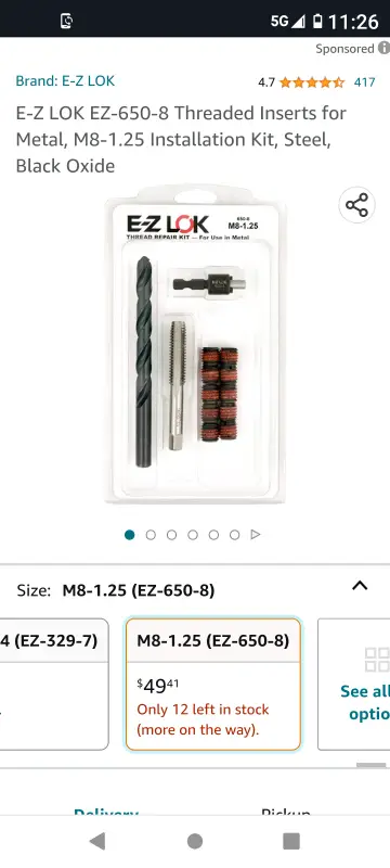

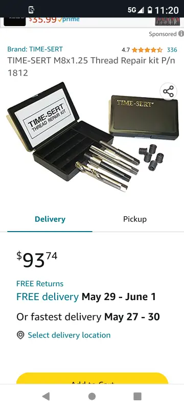

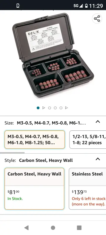

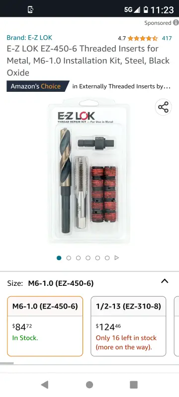

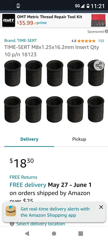

The EZ are more affordable in the individual pack... I like the incert kind over the wire style heili coil...

I really appreciate the help guys I’ll try the JB weld as a quick temporary fix and then definitely get the EZ lock kit for a long term solution.
