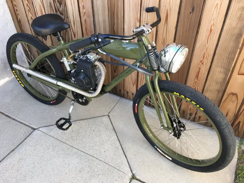

Looks like you did not do your research very well, lots of people have built that same frame, I even had one and did not like the geometry of so i gave it away...it even came with the proper headset for the 1 1/8 setup. You might consider a new headset before you give up and a fork change
I did some research. Ive seen people use 1" conversion headsets and used threaded forks on these bikes. Down side is I cant find it and the 1" adapter I have is not for the integrated headset like this frame used.
That fork will be delivered today. How ever I went to amazon and purchased the last 1 1/8" sunlite deluxe springer for threadless for $99 that I will have Thursday. Looks like I will be sending this $150 threaded fork back and just use the headset included with the kid. Really didn't want to as it looks crappy and I really honestly don't think a vintage looking build will look right with a threadless handlebar mount. Plus I haven't the slightest clue on setting up threadless properly. I did all my reading on threaded headsets.
