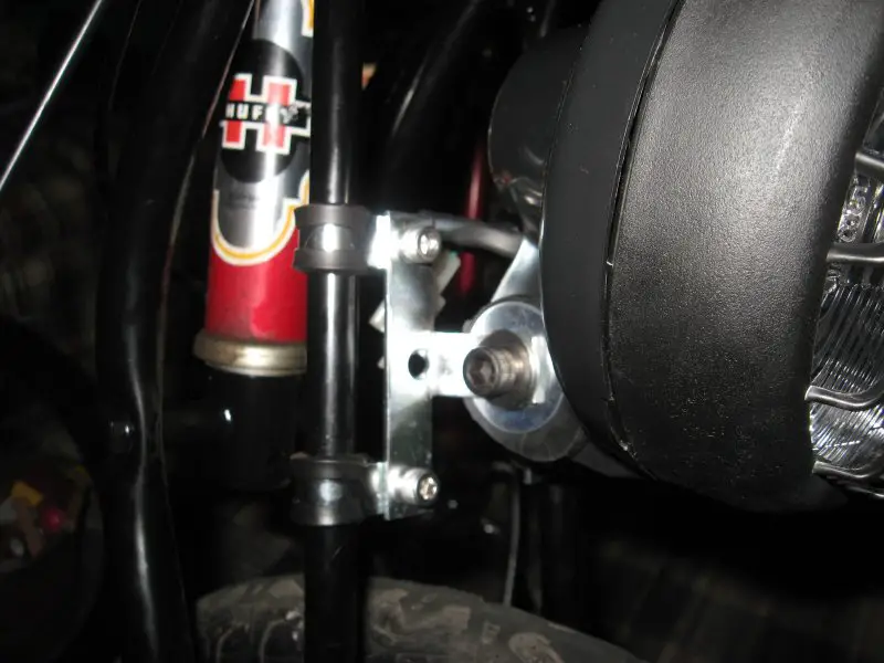

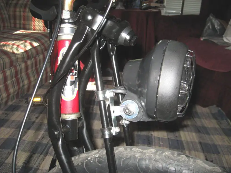

Well I have the head light mounted and it was not that hard to do.
attachment.php
attachment.php
I used a T bracket that I bent the middle leg to a 90 degree angle and cut it down to the second hole in. Then I drill open the hole for a 5/16" socket bolt that goes through the light.
attachment.php
attachment.php

Still need to wire it up, so right now it is more for looks than anything. Waiting on my LED and heat sink that I ordered for changing it over to a LED bulb.
Looks right. Have you checked out how much bounce you get at night yet?
When I took it out for a ride today after I put the light on it I didn't see it bouncing up and down that much as the forks compressed and uncompressed. The proof in the pudding will be when I have power to it and it is lit up.
