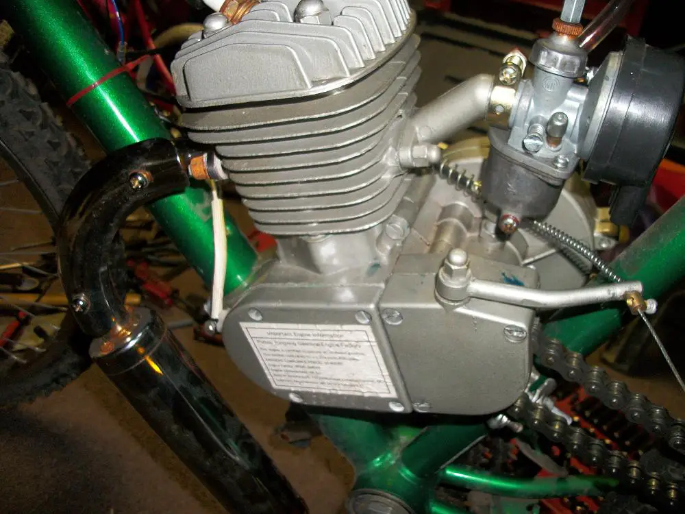

I bought this motor kit probably 2 years ago and never got around to finishing it. Today I finished it up but its not working properly looking for a little insight. The clutch is not functioning at all the motor is always engaged. Also I tried tried to start it with no success, I have great spark and i even dropped a bit of fuel in with the plug and it didn't kick over. Any help someone can give me with trouble shooting my clutch problems and or my no start was planning to take a look at the carb tomorrow.

If possible, post a pic of the engine so we can help you more.
going to head down the road now to take a pic of the motor carb etc but yeah i already manually moved the clutch lever about as far as it would let em and the motor was still turning over while i moved the bike
While i was down there i took that cover off the clutch and i moved the clutch lever and saw no changes but manually there was movement so obviously i need to tighten the cable but still I moved it manually and it didn't work what would be the first step in dealing with the clutch as that will make this much easier to try to start.

And get rid of the small spring on the cable. It serves no purpose except to make the clutch harder to pull. It's a mystery why they put that thing in the kits to begin with. The larger, 1/2" diameter spring is a heat shield. Keep it but discard the small one.
Is there a gasket between the intake manifold and the cylinder? I don't see evidence of one in your photos. There should be one there.

yeah there is a gasket there it is just painted silver guess this company assembles everything then paints it instead of painting each part then assembling.
also how much twist should i have on my throttle grip mine doesn't have much at all is my throttle possibly bound up in the carb from sitting this motor is brad new never run i just bought the kit and never finished the project due to lack of tools at my apartment and time and such.
got it running clutch was stuck fixed that slide in the carb was stuck got that moving and also located a primer that i didn't know the bike had lol this thing is really fun on a side note what are people doing for brake or do i just have crappy brakes i find that they don't last very long without needing to be adjusted
