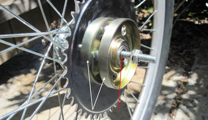

OK just un thread both of them and the put them back on one at a time and this is not a hassle we are both learning together you are learning how to work on this and I am learning how to teach you it is a WIN WIN

The drum and the sprocket (white arrows) are touching.... or at least i cant slide a piece of paper between them.... and I cant spin them off/on separately or together... i have also loosened all of the retaining bolts (red arrow)... still nothing.... I rewatched your video and you definitely had them separate putting them on... and threaded them clockwise?.... any more ideas?... or do you know a good place to start adding some good old fashioned "Persuasion" to that drum or sprocket to make it do what i say? Thanks again Terry

WOW! just got it... nailed the chain to the ground... wrapped it around the sprocket.... and it did what i told it.... looks like the sprocket loosened itself into the drum and locked itself up a bit.... Thanks for everything guys!

LOL sorry I didn't get to you sooner glad you got it was just like you said the got locked together and needed a little nudge and that is just what you did. There is a difference from yours to mine that is mine is a free wheel but they are still the same the both thread on mine will free wheel but yours will not and that means that yours can thread its self off if there is resistance like you brake dragging. Try to not spin your wheel backwards when you are ajusting the brakes
