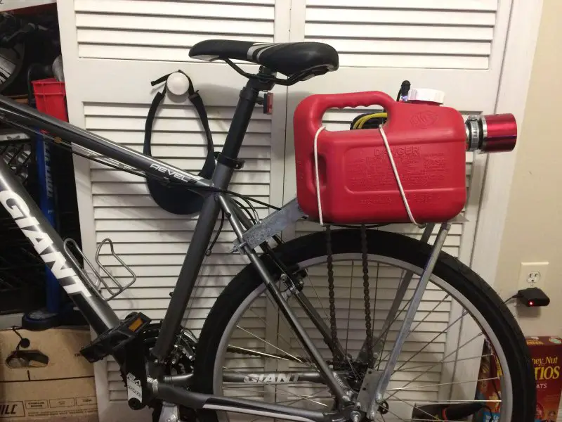

Starting new build. It consists of a Giant Revel 2 Mountain bike with a Staton 18.75:1 Outside Gear/Chain kit mounted to a Chung Yang GP460.

Any Ideas for a gas tank? I do not want a chineese peanut one that comes in the 68/80cc kits. They leak at the petcock and gas cap. Thanks

It might not look cool. But it is functional and doesn't leak like those chineese peanut tanks that come with the kits.
