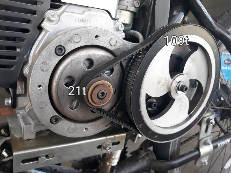

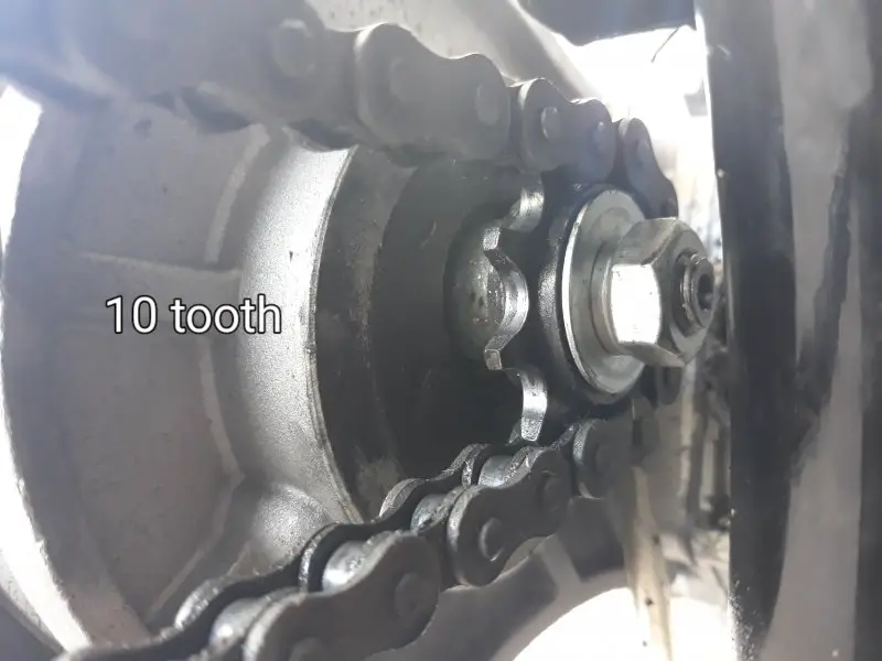

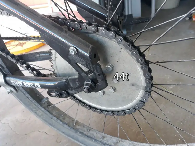

20190807_154133.jpg I get 24 mph on flat ground, no pedal assist, full throttle.
i want to keep my power, and go faster. Should i replace the 10 tooth trans gear for a 12 tooth?
I have the centrifugal clutch (belt drive) going to a 109 tooth rear trans gear, directed to a 10 tooth gear that pulls the stock 44 tooth rear sprocket.
How can I change some gear sizes to go faster while keeping my power?
I'm planning on getting a 41 tooth rear sprocket soon.

I thought about it more, changing the 10 tooth to a 12t would slightly reduce power, but give me roughly extra 3mph top end.

Actually, reducing the rear sprocket by three teeth will give you about three more MPH.
