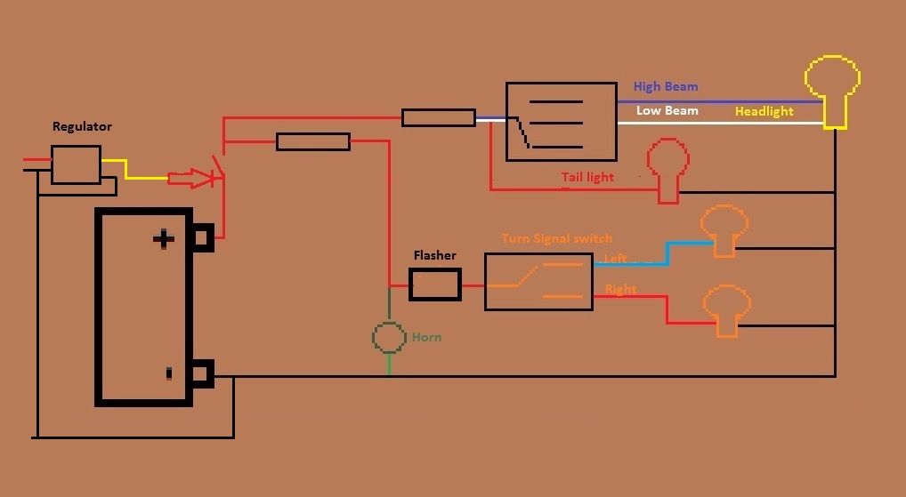

Ground for DC voltage from the generator should be connected to battery too, but didn't have it drawn on there.
and
I didn't have the rear turn signals on there, but it should be running in parallel with the front turn signals.
I am running this same dc motor with a similar voltage regulator. I found that I needed to run a diode in between the motor/generator and the battery, because the motor would draw power from the battery and drain the battery. I put the diode on the positive wire.

I'm tempted to run two diodes. One from the + connection just after the generator to the positive input terminal of the regulator so when i do maneuver the bike in reverse, it wouldn't fried the regulator. Another diode at the output of the regulator to prevent unwanted voltage from the battery feeding back to the regulator.
In theory, all I really need is a diode from the generator to the regulator, but might as well have another one. Diodes are cheap.

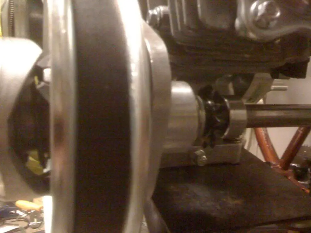

heres my kubota on a honda gc160
that kubota looks so compact on your setup. I'll look closely on my bike to see if I can have the same setup as your. At the moment, I think i might need to mount my generator underneath the motor mounting plate.
