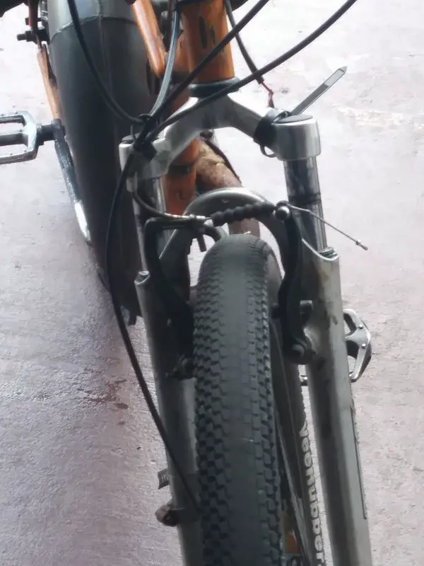

my new ones worked a little while then became soild so it took like 20 minutes to repair. two long springs on the bottom of forks screwed onto the two fork pins, then the housing slides on with plastic bushings and grease seals. water made em rust and get nasty, now work good all cleaned out again.
