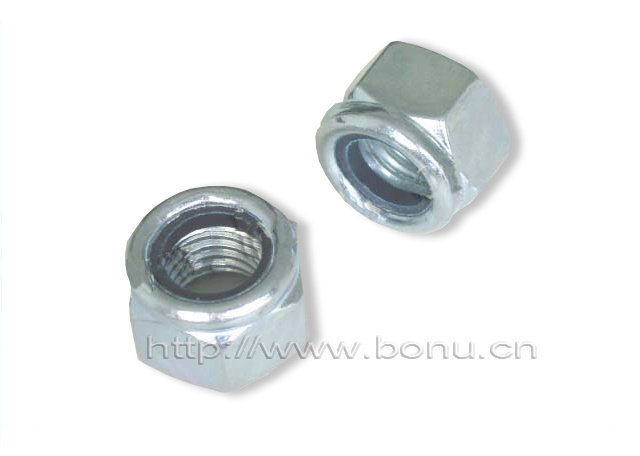

I put a little loctite glue on all my nuts,I have a year plus on the bike and all nuts are still on tight.By the way Tudor the bike looks great,good job...
Go to any hardware store, and get some self locking nuts. Basically they have a nylon ring on one side, so they won't come off. Most probably all 6mm.

I'm seriously considering replacing every single nut and bolt that came with this kit. They truly are of very poor quality.
