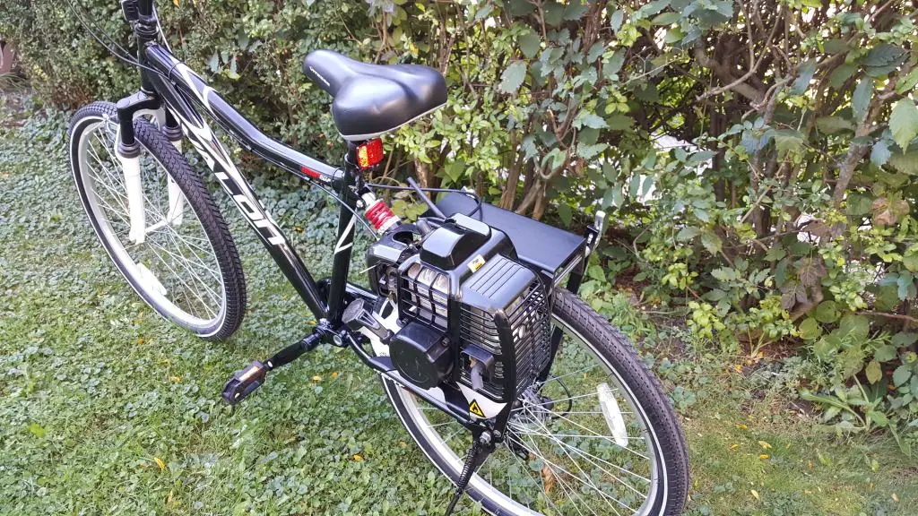

Well, after a year of blood, sweat, and tears, and especially money. Along with lurking on the forums. I finally (nearly) completed my build.
Runs great but still had hiccups. The 415H chain on the rear sprocket likes to go between the sprocket and the spokes. So I used the stock tensioner (not on yet fully) to keep it lined up. Was debating on going #41 or just save up and go all out with a jackshaft kit. So far I clocked it at 25mph max with that 16:1 mix.. wich I found out kills power, so now running 40:1 for now.

It's a nice looking bike. I've pondered building on that platform before simply because the rear suspension would be a nice feature. But I've held back because of the issue of engine chain tension.
And it sounds as though that might be your trouble. Going with a 41 chain never hurts. But I doubt if it'll get rid of the trouble completely. But maybe a spring mounted tensioner?

Beautiful build, always loved the Avalon personally. The stock chain tensioner helped me out with keeping my chain out of the spokes. Hope you can get the chain jumping issue solved, never hurts to try the #41.

Been thinking it, and possibly bend one to realign the chain. Along with redoing the intake do make it breathe more easily. Also anything to get more bottom end power. Especially with these hills here.. very steep. Plus with a shift kit later on, convert that power. Plus, has anyone tried to do an electric start for these 2-strokes?

Welcome to the forum and congratulations on your first build.
A couple of suggestions: The chain tensioner should not be used to "guide" the chain onto the sprockets. It is a 'tensioner', not a 'guide'. If the drive and driven sprockets are properly aligned you should not have to guide the chain.
Any movement in the rear wheel, up or down is going to impact chain tension to some degree. For an unsuspended rear wheel we recommend 1/2" to 3/4" of slack. You might have to experiment and do some reading here on full suspension builds by other members to see how they have addressed the rear wheel movement issue. I know some have gone to a spring loaded tensioner but try to avoid those if at all possible.
A good industrial quality #41 chain is superior to the kit chain. Kit chains are notorious for fast wear, kinks and rough spots that might be contributing to your chain derailing problems. #41 chain is available through Grainger, Tractor Supply, most any industrail supplier and even some Ace Hardware stores carry it.

Yeah if properly, sadly nothing ever goes perfect for me and gotta make do with what i got. Also I did find a 41 chain that's nickle plated online.. Plus there's only truevalue around here after Ace closed. :/

I had a thought regarding chain. I was looking and found KMC K910. Wonder if that would be a decent upgrade vs. a nickle plated 41.

I'm just spitballing here, but does that rear spring have a tensioner? Because if it does, then you could just tighten it to remove some of the chain slack issue. But of coarse that won't remove the issue, just limit it. Also it will make for a less comfy ride.
