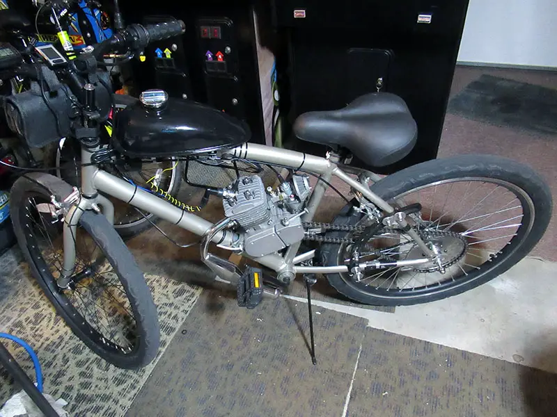

My first build was a Kent Sea Change. I got it for $75.00 from the local Wally World. It's a bit small for me so it's going to my 13 year old son eventually... I'm in the process of building a 2nd project using a much more suitable Hyper Cruiser frame (currently being powder coated) and I'm rolling the dice with a Phantom 85 on that project... but that's for another post.
Now on to my first project... "Tang"...
As she sits she's rockin' an engine from Hel•io Motorized Bikes...
I immediately updated the stock kit with an arch tensioner and CNC Hub. After some consideration I updated my back rim to a heavy duty rim designed for motor bikes from a company that I simply refuse to promote (long story... great rim, HORRID at taking responsibility when issues arise). The rim includes a sprocket, and since this is going to my son I backed down from a 40T to a 44T to slow it down a hair. The tires are generic "Flame" style tires had from Bikeberry... the intake is a stubby CNC intake from Amazon. I added a "Speed Demon" (ironic name since it really doesn't add much speed, though it sounds nicer) exhaust. A new seat was needed as the stock Kent seat was quite uncomfortable for my rather large frame. I added some mirrors, a speedometer computer... a tach/heat meter... and replaced the stock front rime with a higher quality and wider rim I had in the garage. Of course front and back lights were added and a tool bag. I did upgrade the tank cap to a Honda OEM cap that works great and doesn't leak. I do need a better kickstand (likely a double leg stand) and I'd like to add a luggage rack to the back. Oh... I modified a Chinese $6.00 air filter to work with the NT carb as well.
With the 44T sprocket it'll do a hair over 33mph but I typically cruise around 20-23 mph.
The new rims made a HUGE difference in how "safe" it felt. The stock rims were quite sketchy at any speed to be honest...
