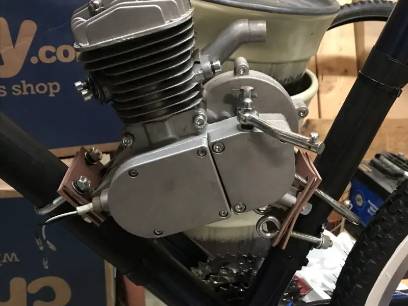

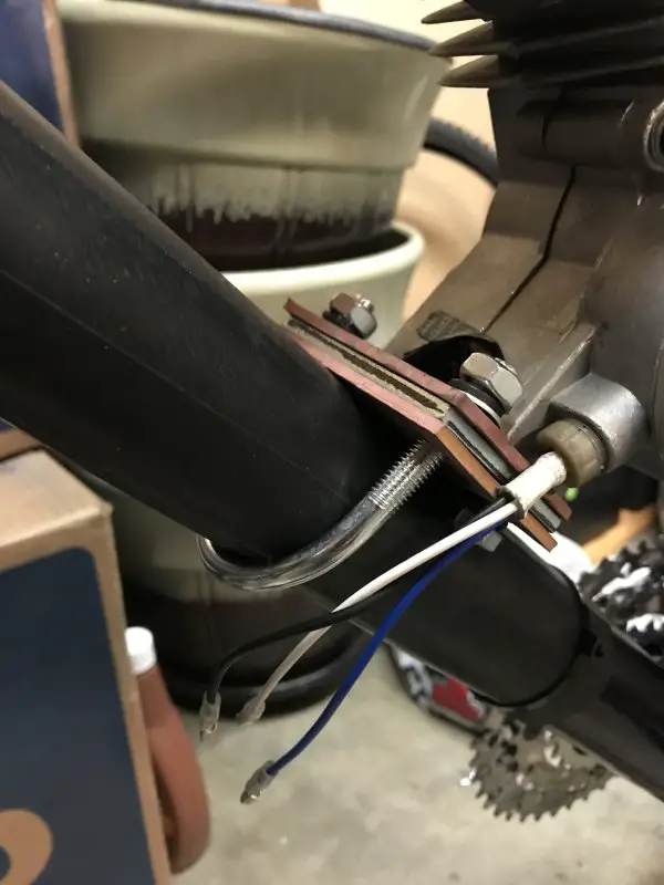

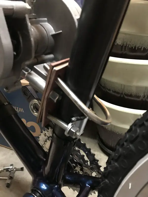

I had a problem with both tubes being a tad to big like it almost fit and what it looks like the person did to fit on the old engine was they bent the studs just abit anyways this is what i did. I need to still get a ubolt that will fit on thr seat tube but i put one there so you can see what goes there. read you arent suppose to use rubber but i did my instructions manual said to but not sure exactly where.
The rear mount has to be solid, if not you'll get a lot of vibration. I can think of a few ways to make a custom mount but if you don't have the tools it won't help. I would measure the seat tube and find a thick wall pipe that closely measured the same width I.d. and cut it length wise and use half as a saddle to weld to flat stock. I've made a couple over the years.
It’s weak. Those u-bolts are going to crush your frame tubes and weaken them at those points, and get loose at the same time. What Greg said, but if not you can find the ubolts that have the cast clamp pieces to distribute the clamping force. Use solid steel plate like 3/16” instead of that weak sandwich you got goin on.
If the studs on the motor clear the frame tubes, you can just grind the stuck mount blocks to fit the tubes.

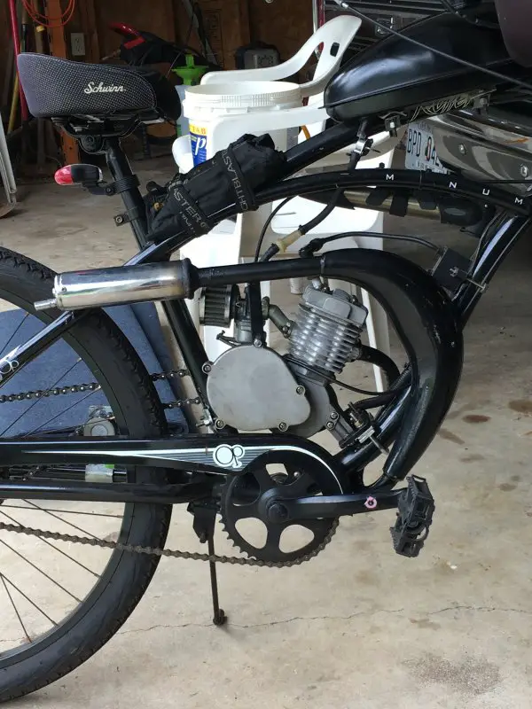

The mount on the bike in the picture below I made, notice I took up the space between the mount and frame with metal not rubber. The problem with rubber is it will continue to flatten out and cause a loose and vibrating engine. If you notice the rear strap on the back of the seat tube it is probably 3/16 thick.
