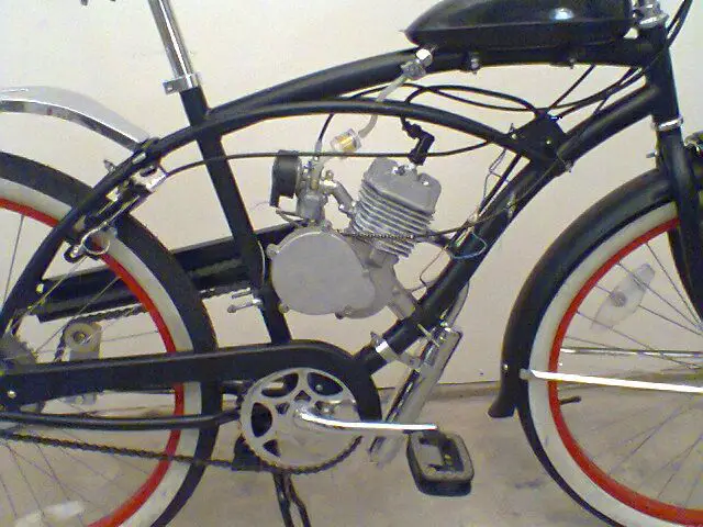

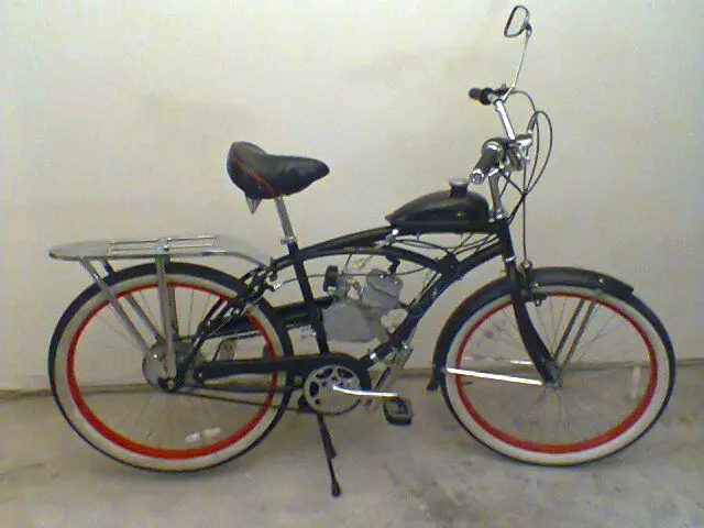

Here's my project so far....
https://docs.google.com/file/d/0B-C7D5hqhsBiaE9jX1ExWEFvejA/edit?usp=sharing
added front and rear caliper brakes and switched out the wide cruiser handlebars for a pair of Wald 803 bars,
Venice Motor Bikes 66cc engine.
Just need to seal the gas tank, (already had a little rust when it came), install the chain, tank and fuel line, and trim and route cables.
Any comments and suggestions welcome!
I'm already planning on upgrading to HD wheels with sturmey archer drum brake hubs as soon as I get some spare $$, but the calipers seem to work okay just pedaling around.

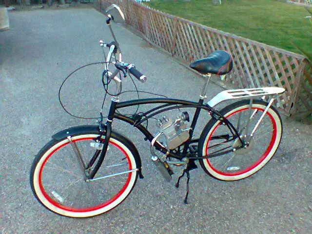

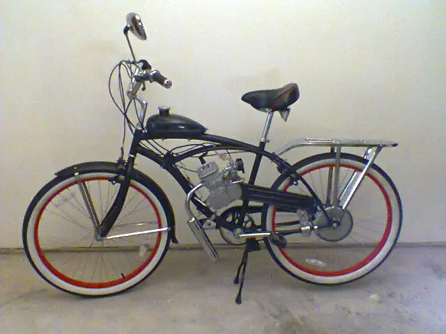

FULLY OPERATIONAL!dance1
I replaced the chain with #41 from my local small engine shop and then
I cruised around the neighborhood for a total of about an hour today. hit about 24 mph at 3/4 throttle on flat ground. but the speedometer is only giving intermittent and usually inaccurate readings.... Any tips on fixing this?
I moved the CDI up underneath the gas tank, and flipped the sprocket, as well as dremmeled a little off the inside of the sprocket and the clutch cover where the chain had hit a little.
The brakes were a little sketchy at first, but I adjusted them as well, added some loctite to a bolt that had come loose in back. The coaster brake cover no longer rubs on the sprocket now, and the wheel is better aligned so I feel better about using the coaster brake now too.
