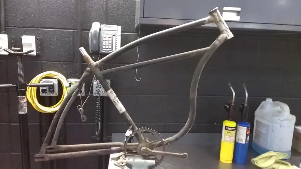

.we.Hello everyone, last night I picked up a cool looking straight bar frame from the local CL, with the intention of using it as my first motor bike build.
I'm starting this thread as a log book of the whole process and I'll updated as progress moves along.
Here's the frame I bought:

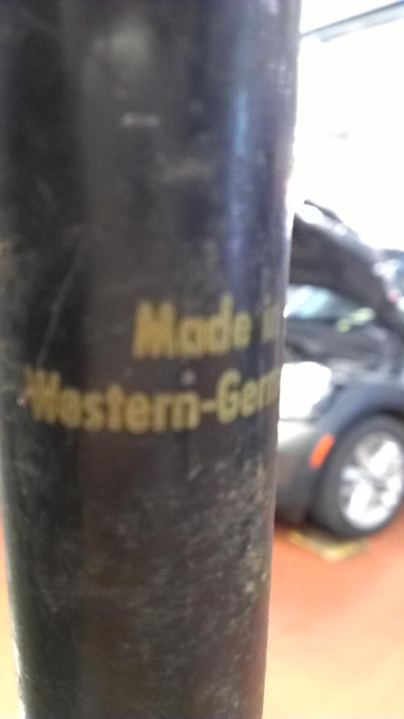

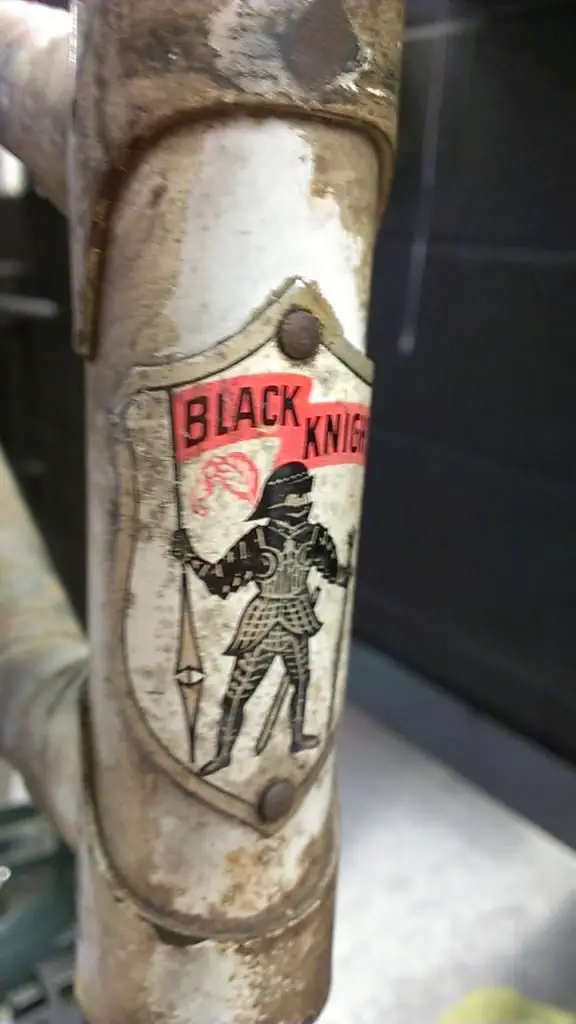

From the seller's description, he said it was from the mid 50's. The badge reads Black Knight and it says made in Western Germany.
Seller's pic;
Using some heat to line up the rear triangle, it was a tiny bit off.
Head badge. Now removed for future use.
Crappy pic of the "made in" info.

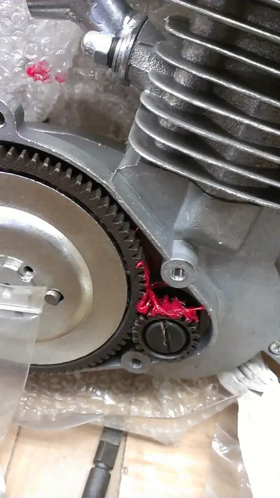

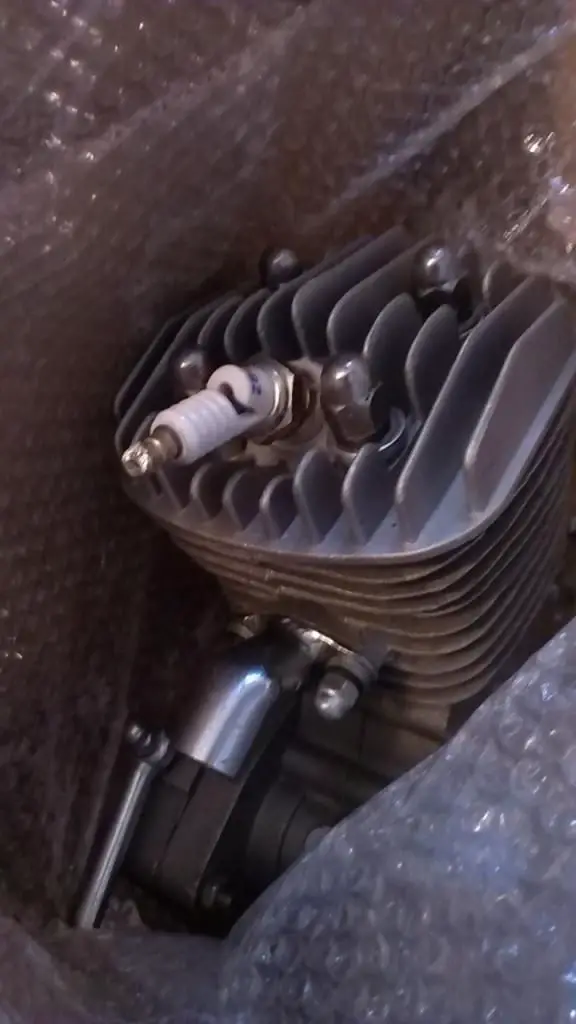

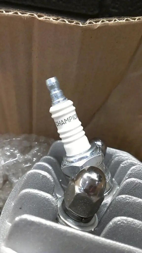

Well I was extremely happy to find a FedEx package when I got home but after opening the package I was upset at finding a broken spark plug.
Luckily after giving the complete engine and all other items a thorough once over, I didn't find anything else broken or damaged.
I was also planning on buying a new/aftermarket plug, since I was not a fan of what was included, so no biggie.
Look at this lil' guy ;)

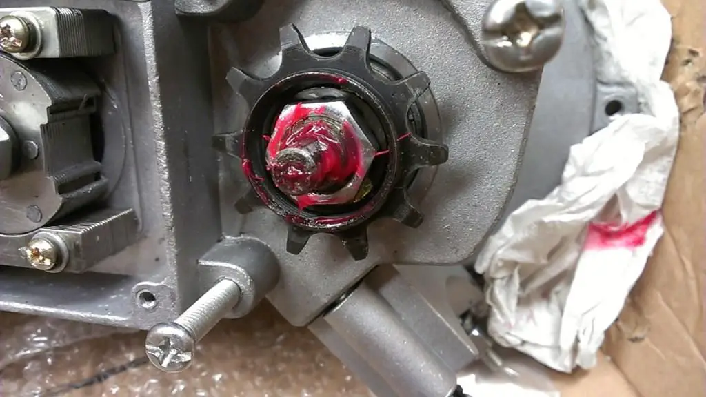

While waiting on the powder coating, I've done the following:
Replaced spark plug, studs and gaskets.
Ported the intake and exhausts manifolds.
Shorted muffler inner exit pipe.
Added new Mobil1 grease.
Added threadlock to all new studs.
Just doing the recommended items I've read in the forum ;)

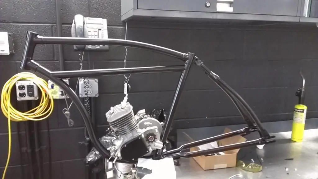

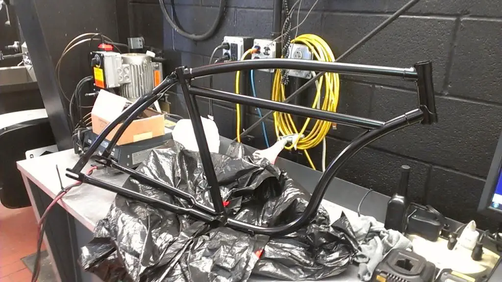

Sorry for the delay but between the wait for the powder coater and trying to source a gas tank and a few other parts I haven't done much. Unfortunately an in-frame tank is not monetary feasible at the moment, so I ordered a rear-rack one. The plan is to fabricate and powdercoat a metal plate to go in place of the frame tank and make a decal with my "brandname".
Here are some pics and then some more questions :)
This is the frame right after getting it back from the coater. The color is a semi gloss black. I didn't want a full flat-black nor a gloss, so this worked out great.

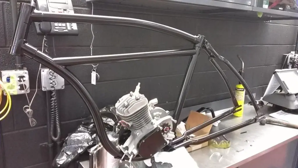

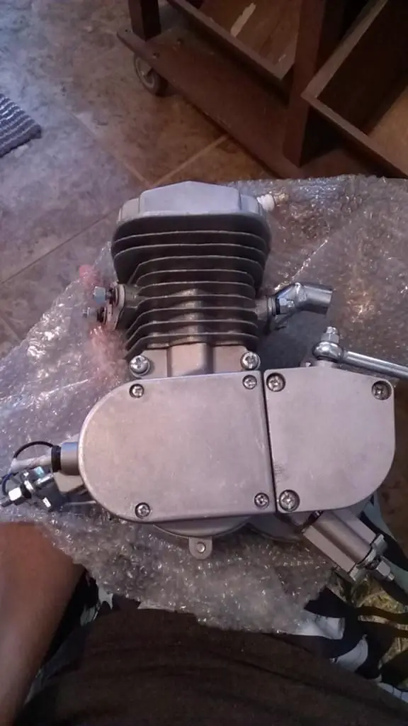

Here are some engine components.
Mocking up the engine.
More pics coming!

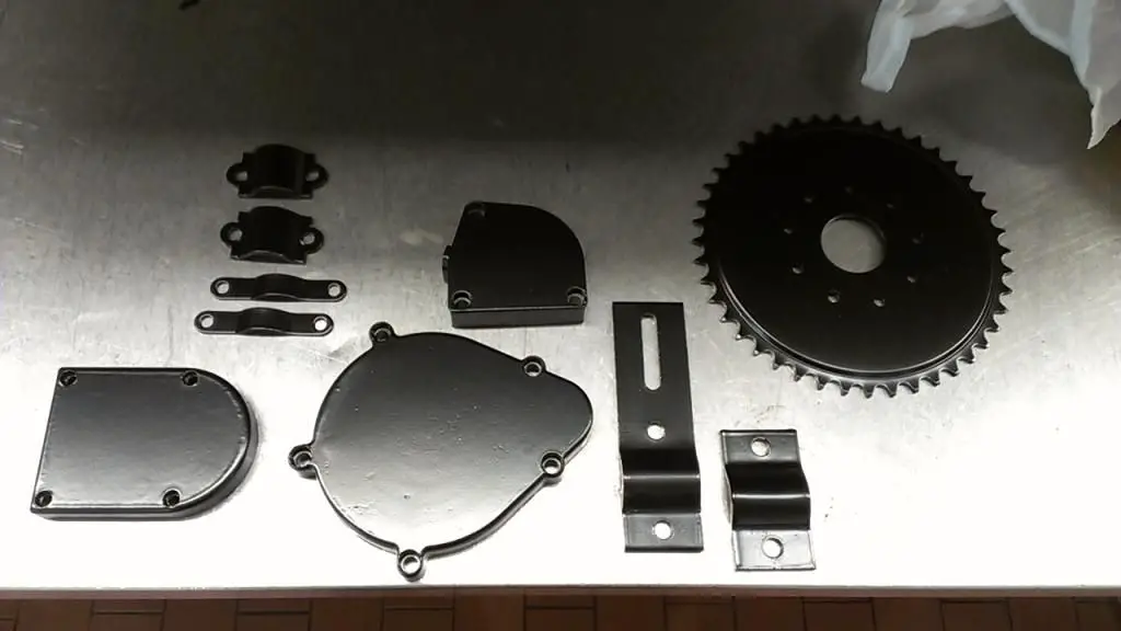

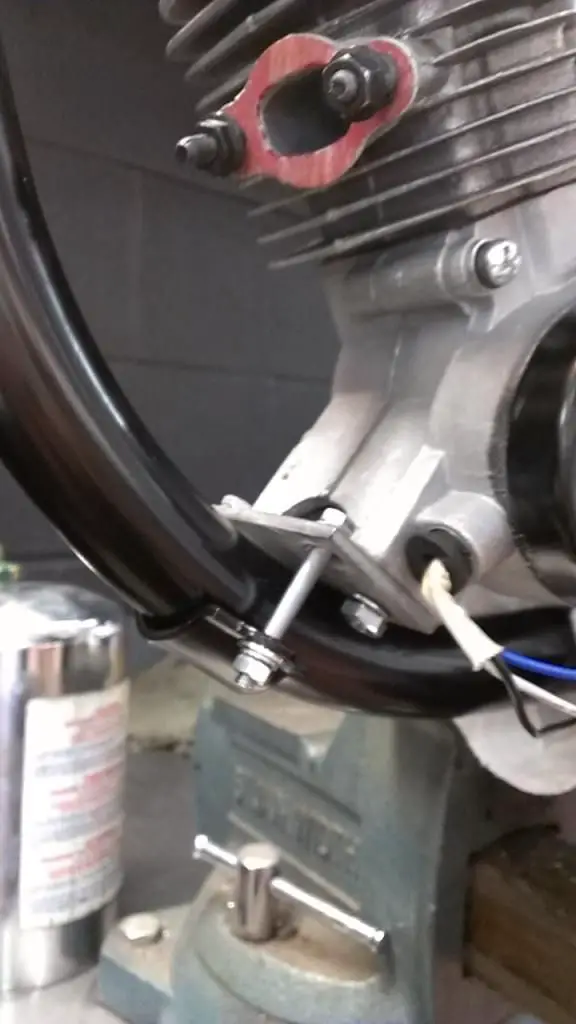

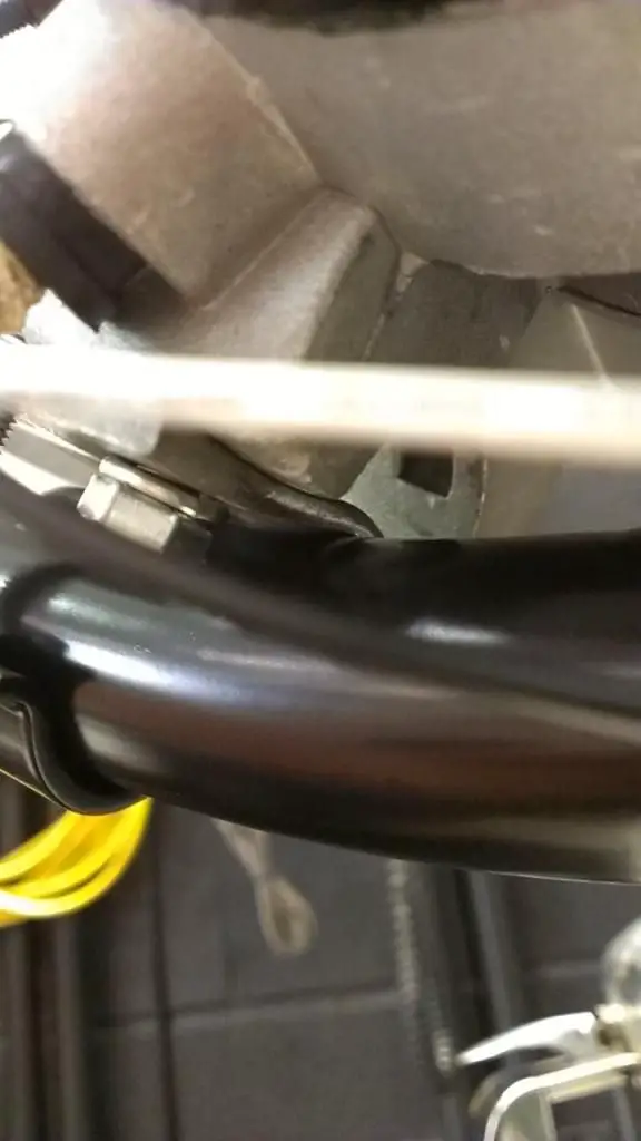

I didn't like the front mount setup so I played with it a bit. These pics were of the first mock up, the mount is now bolted with thicker/stronger bolts and the engine is rock solid.
I formed the top plate to sit flush with the frame tube. I didn't like just the corner/edge of the plate making contact. I have formed the plate even more, so it has a greater contact point.

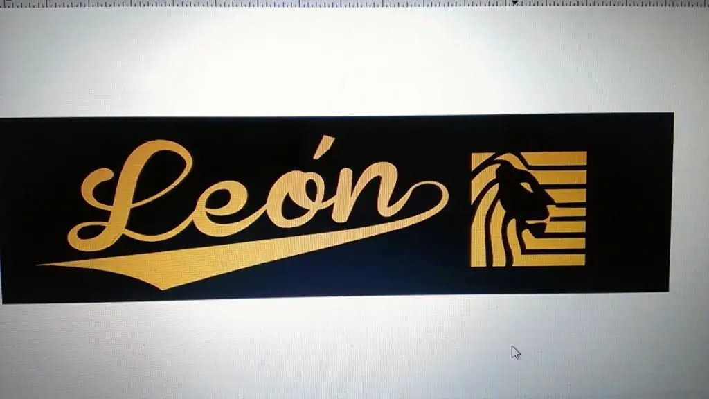

Here's the logo that will go on the in-frame plate where the tank would have gone if I had more money ha.
Hope you like em!!!

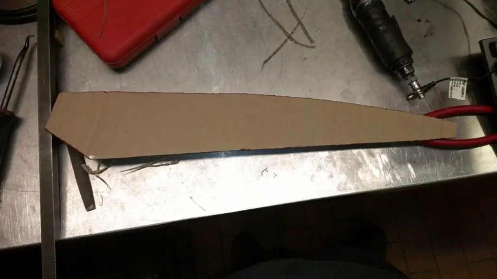

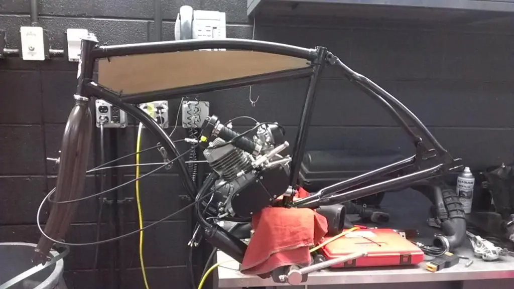

Making the in-frame tankless plate. Cardboard cutout.

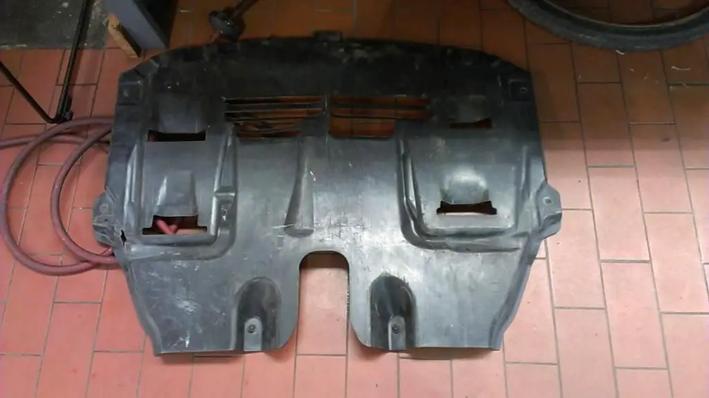

I'm using this old under engine panel from an old cracked piece. The piece came from the top part of the shield.
Here's the final product, although I'm not sure on the color. Also don't mind the forks, those will not go on the bike. I have ordered some springer forks. I painted the plate a gold metallic color and shaved it a bit more to fit flush.
I'll make sure to get some better pics. I think for now the frame plate will do the overall design justice, so the gas tank will not be needed anytime soon ;).
