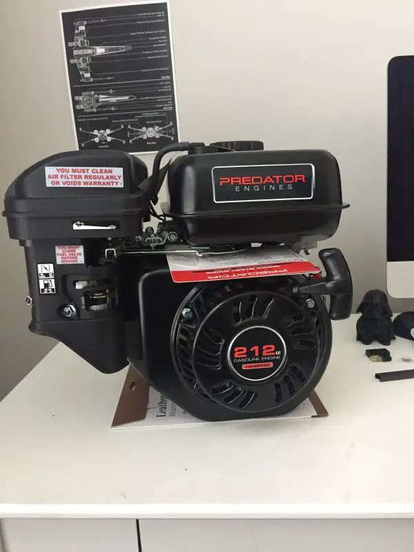

After months and months of research, longing to build the ultimate motorized bike. I’ve finally pulled the trigger on the start to me build. Purchased the big ol predator 212 motor. Couldn’t tell you how stoked I was to get it in the mail today. From the ground up, and the help of some good Cali friends, well be building a 212 fat tire cruiser. I understand the difficulties, and the funds associated with this decision and all I gotta say is let’s do it ! Plz let me know any forums or post that might help with the build down the road.

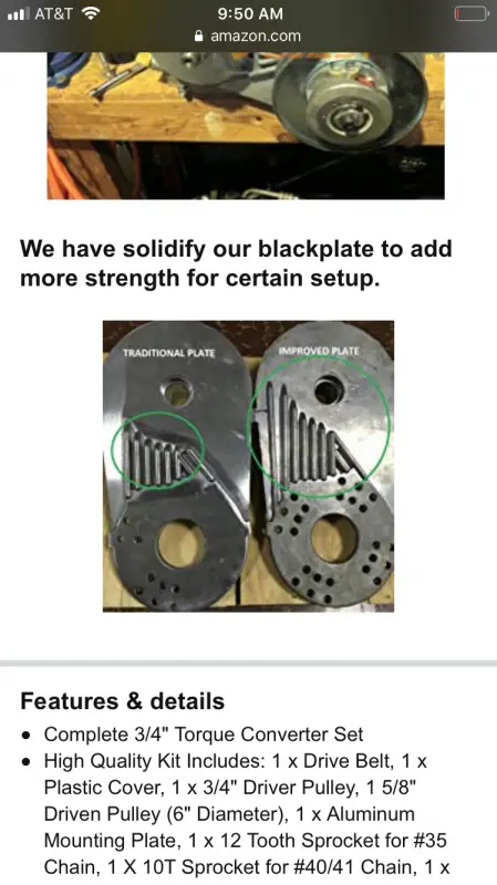

I was planning on going w the blast 212 torque converter. 44 T on the rear for the motor sprocket, small single speed freewheel on the the pedal w a small discrete 32 sprocket pedal and crank set
Sounds good, got to watch the mount plates for the torque converter, cheep ones are known to crack...........Curt
Yeah I wasn’t gunna say the China kits look like trash. This blast kit supposedly has an updated plate vs the other mount plates.
