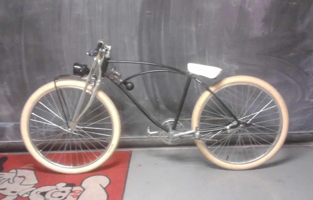

finished my first build
Thanks for all the kind words guys. Anyone have any suggestions on a good head that's in stock. Preferably under $90?
the advice Id give is this from what Ive read and I know other people have done get 2 head gaskets some engines need 1 some need 2 put 1 on and spin your motor over to make sure your piston dont hit the head if you feels it hitting then pull the head back off and put the 2nd one on. you can ask glennbo about it he had to use 2 gaskets because his piston had a kind of big dome. you also might have to change jet size with that head you will almost double your comp.
Nice theme build, extremely well executed. I love the horn.
I see that springier around. Does it seem beefy enough and how much does it smooth the ride?
Great bike build! I guess lurking works.
Thank you!
The fork holds up well enough I guess. Its just a cheap walk one I think. Rides smooth. If it gets real bumpy it will start to bob especially with the springer seat
I found some pictures of when it was just a bicycle and then mocked up with the stock yank. Any time I feel my tank is too big I'll just look at this picture
