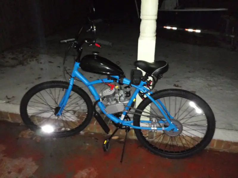

Finally got her all together!!!
Feb 8, 2021
34
14
8
29
I'm so excited and stoked for tomorrow everyone, I just finished my first motorized bicycle. I've got to get gas tomorrow and then I'll mix the two and fill my 4L tank up and ride, then I'll officially been apart of the motorized bicycle club right??? I ended up purchasing a 38T sprocket and adapter and she worked beautifully. Now I do have a little problem I haven't started this engine yet and I've fucked with the fuel and air screws on the carburetor cause I want thinking when they said make sure everything was tight and I didn't remember how far they was screwed in our out, it should still start right I'll just have to **** with it heavy now to find the perfect idle and what not. All in all I'm excited about this and can not wait to ride her. I need to make her!!!

Thank you for your help. So what I'm going to do is screw the A/F screw in all the way then bring it back out 2 full turns out. Then I start the bike and I adjust the idle screw accordingly until she sounds about right! Am I correct with this?

Hey also I've noticed from alot of videos I have the cap where the spark plug goes in backwards is that okay will it affect it any or should I turn it to where the spark plug is facing the front tire like I see in other people's videos??

Okay cool thanks so here is my new problem. So while riding when I go to come to a dead stop my bike will cut off instead of idling why is this?

Well I got an even bigger problem lol. She is not rideable right now. My damn chain tensioner from all the vibration turned inwards to the spokes and got jammed in there and busted and popped out like 6 spokes, so that rim is trash now LMAO. I already ordered another one, now I got to get a new and different tensioner.. smfh!!!

Yeah I want ahead and bought one of those chain tensioners that bolts to the engine, I'm even going to loctite the damn thing this time lol
