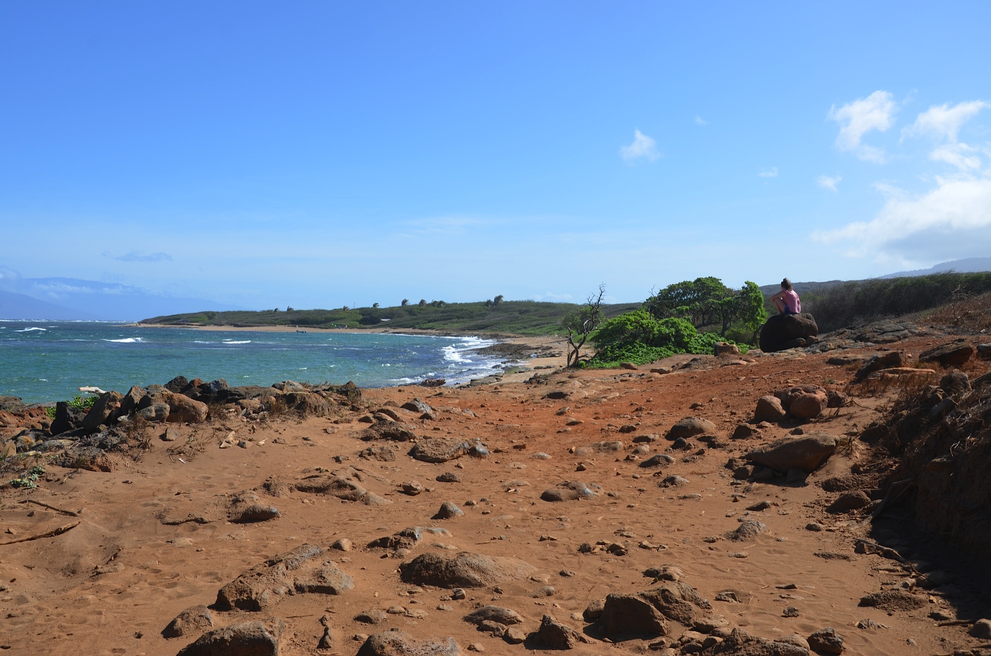

As for our roads... not sand that would be too simple. Imagine a rock quarry, with all the loose sharp rocks. Then make the edges on those rocks sharp like broken glass and you'll have an idea about what our road looks like. I'll have to go out and take a picture one of these days, but here's a pretty good example.
Those roads dont look like fun at all! Maybe a BMW GS would be better-lol. I really havent had any chain issues slap or other wise from my Xtracycle with a similar long chain and no idler. Could do like on a recumbent and figure 8 the chain, would add clearance too. Kevlar tires would be a must!
The road can be fun if your into dogging rocks, which I am because I grew up mountain biking and quadding, but there is a definite need for shocks on a road like this. Which has so far been the failing of every cargo bike I have seen. There's one guy in Germany that takes Bullitts and modifies them, adding electric motors and shocks. but its an extra $500 on top of almost $2000 and I don't even want to imagine what shipping it to Hawaii from Germany would cost!
