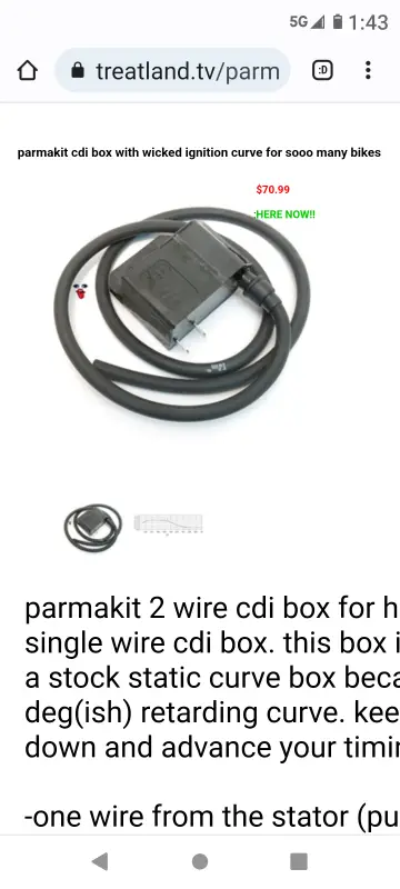

Put this with it and your going to like it...
