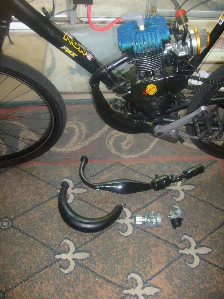

Since you can weld, I suggest building your own pipe to fit YOUR bike perfectly.
The store pipes have to be a compromise to fit more than one bike, but a custom pipe can be built easily and will fit better than 99% of the aftermarket bolt on's.
You can tailor the power to fit your needs and equipment without having to settle for whats available.
Good rules of thumb when fabbing a pipe:
Short and fat = torque in low and midrange
Long and slender = high end rpm
Keep the header around 12" to 16" inches from port to chamber when starting for best results
Tune with header length once you get close to the kind of power you want.
Here are a couple different pipes I've built lately...
My current ride, The Pig ver 2
The Pig ver.1
Original Pig ver. 1
Original Pig ver.2
