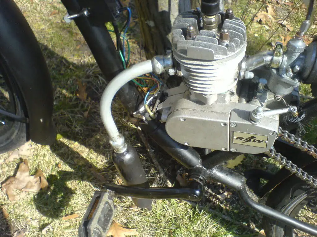

I had a some issues with my exhaust set up. I could not get the exhaust to clear the frame of the bike. I tried all the trick and eventually bent the exhaust pipe and was left with a not so sightly exhaust pipe. In an attempt to make lemons into lemonade i came up with this mod. I hope it can keep a few exhaust pipes out of the landfill.

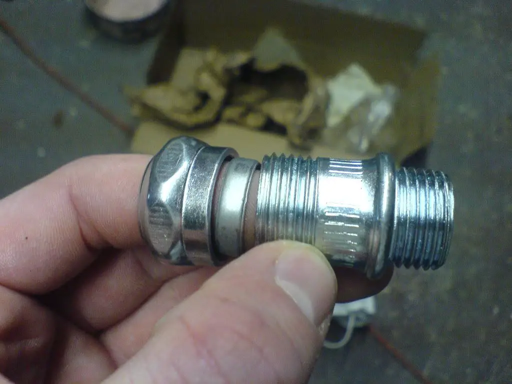

The compression fitting disassembled

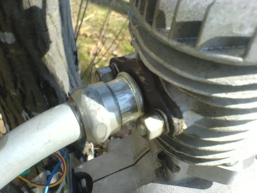

The flange is threaded. the compression fitting is shortened so it does not extend past the flange.
The muffler is threaded
finished product. strap can be affixed.
The whole setup can be adjusted with an open ended wrench in minutes. The freedom of motion is much greater than any other set i have seen.
