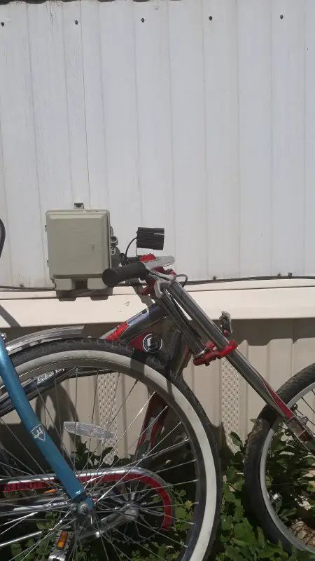

Just managed to pick one of these beauties up. Before I slap the 198cc 7hp DuroMax e-start engine I got for it though, Ive gotta swap the fork for a DNM USD-8 and build new wheels for it. Thinkin of a 170mm 10 speed hub for the rear, and because the fork has a 20mm TA, I gotta make sure that front hub is compatible. Gonna slap 203mm brake rotors on it with Shimano XT hyrdos. Already got a 1200lm headlamp on it.
Anyone around boise who can weld an IS mount to the seatstay? Oh, does anyone also know where I can get replacement decals? If I can't get OEM, theres a place nearby who will make new ones.
