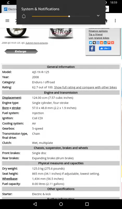

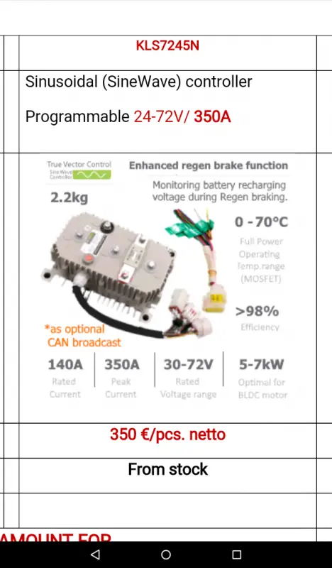

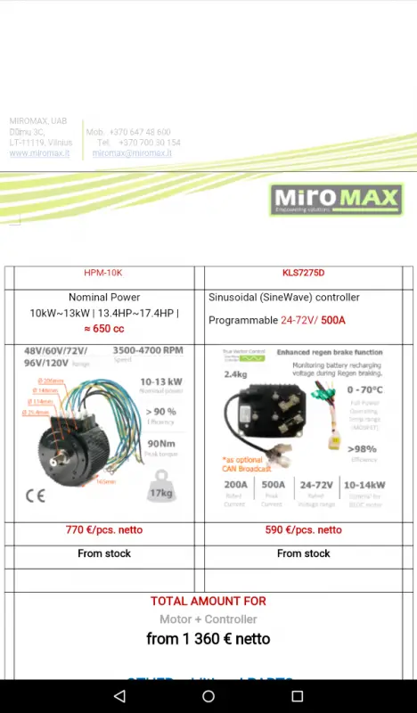

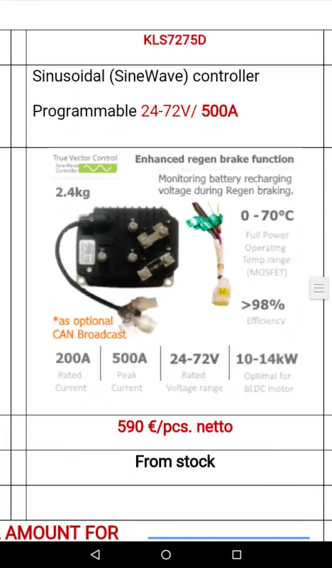

This is the frame I plan to use, not actual frame, just to give idea of what it would have looked like, and the controller and motor combos I am considering outside the normal paired stuff straight from golden motor, I will say there customer service lacks in the human touch, I was considering going 60v at first and asked about if there controllers could be reprogrammed to take 60, they just replied they could sell me a 60v setup, even though I wanted to get a universal voltage controller, so I started looking and found miromax in Lithuania also sells them, with preconfigured aftermarket controllers, so I started looking at what they offered and I have settled in the 10kw motor but am stuck between the Standard controller, or either of these 2 controllers, any advice welcomed, also any guidance on doing a complete scratch built lighting loom as I am starting from a bare roller frame
