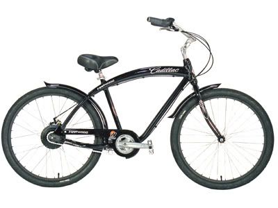

I just bought this Cadillac Fleetwood with the Nuvici CVT Hub and as it has not arrived yet, so cant measure it. I was wondering if anyone on the forum had one? If so can you please tell me the dimension of the seat post.
Thanks
Thanks Flounder, but am thinking the aluminum tubing may be different. Well I am trying to order a SBP shifter kit and they have 3 options 1.125 inches, 1.25 inches, or 1.375 inches. Guess I will just have to wait till the bike arrives to measure it

Dave, sorry I misunderstood your question.. You ment Vetical bike tubing and not seat post right.
Pretty sure he meant the seat TUBE, not the seat POST. Easy mistake since they both have the word "Seat". The seat TUBE is part of the frame. The seat POST has the seat mounted on it and goes into the seat TUBE.

To answer your original question here, the seat tube that the seat post slides into is 1.250" outside diameter....that's an inch and a quarter. The length of that tube from the center of the bottom bracket, to the top tube where it penetrates the top tube is approx. 15.5" on the 18.5" frame. Hope this answers your question...
