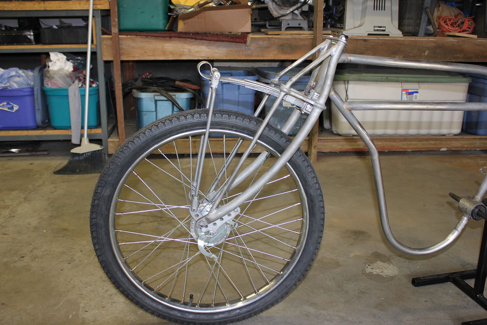

Thanks! That's good to know,am working on a couple myself....what did you use for bushing oil lite?............Curt
Here is a set Curtis Made Man are they Cool!

Yep remember that AWESOME bike, that's what i used also snowmobile springs, but hard to find now................Curt
snowmobile leaf spring, homemade forks and rockers, flanged bronze bushings and shoulder bolts.
