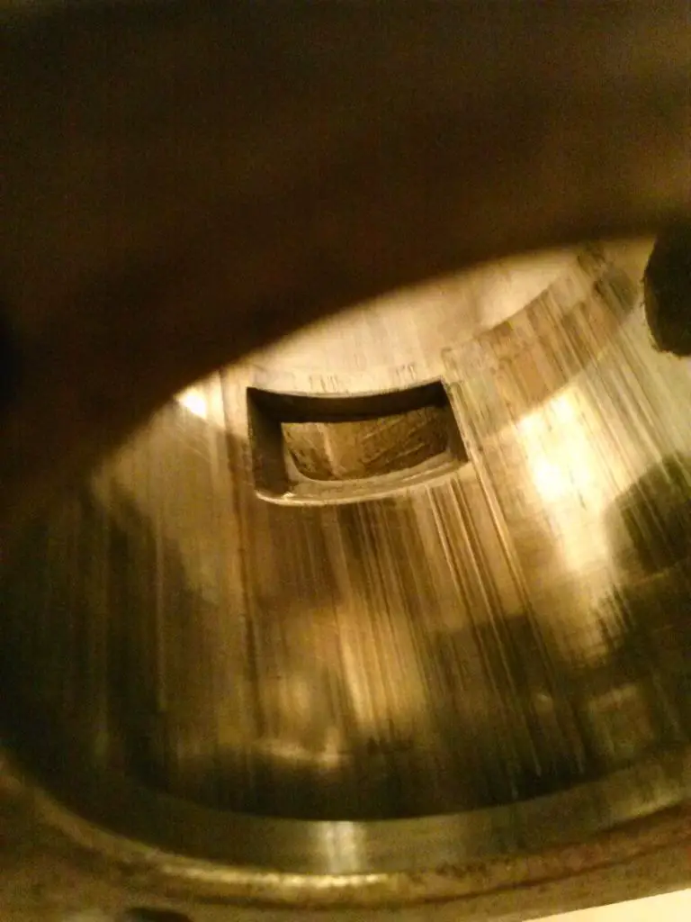

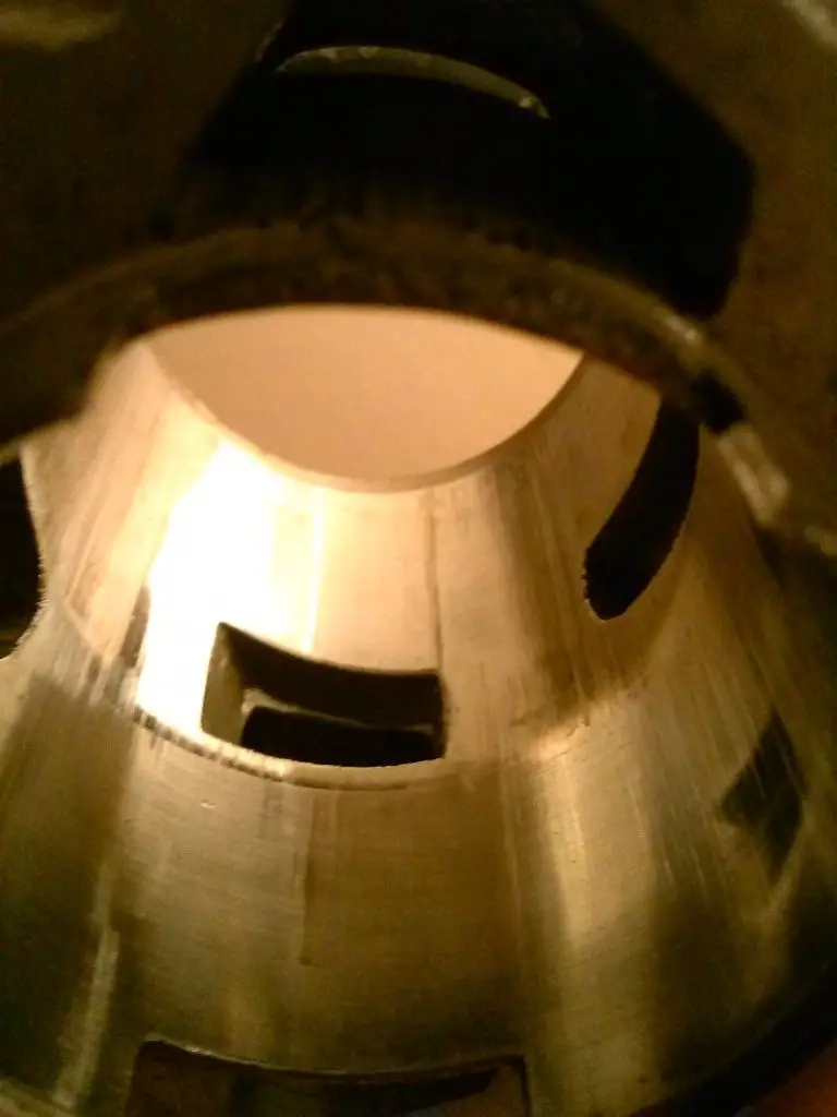

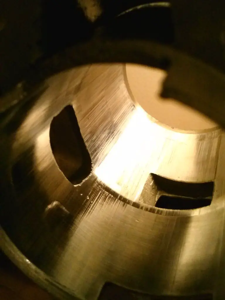

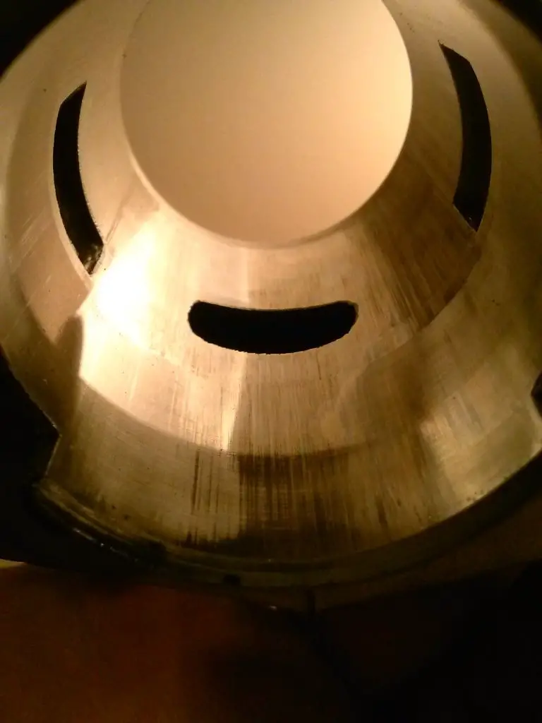

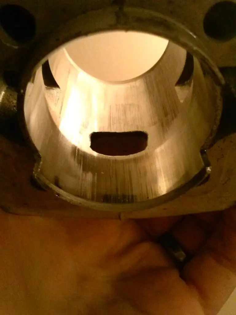

Pics are hard to get in the light, but I think a couple of them show the signs of scoring and some of the pits. Really, there's nothing in there that is enough to feel, so I probably shouldn't be worried about it too bad I guess. Can't even snag a fingernail over any of it.
How about some 1000 or 2000 grit sandpaper to polish things up? That wouldn't flake it off like the hone would, right?

I think I'll just try cleaning up the ports, polishing the cylinder walls, and seeing where that gets me.

I feel like I should have seen it coming, and I really wish I had taken the engine apart before running it. I think I could have prevented the cylinder wall scoring and pitting, but if it dies it dies, and I'll rebuild.
