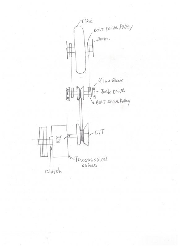

I was planning on building a diesel bike build, 7HP 305cc at 3600 RPM - It's part of a Zombie Apocalypse Survival theme, it follows a battle crafting theory.
Putting redundant backups in place and fuel ⛽ was the choice for the engine for biodiesel fuel. I also came across a 3-speed transmission with reverse.
I also decide a CVT would be good in there as well.

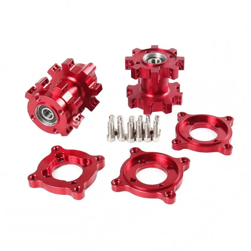

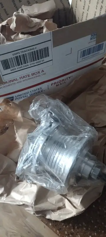

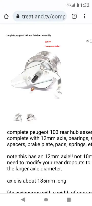

I was thinking of doing a dual belt drive and/or chain drive, so I also decided on motorcycle wheels because I can get the hubs to work. I think so
Just of matter of ordering two sets to use the plate, they have bolted on and drill and tap the other sides this way you can have dual disc brakes and dual drives mounted
that's what it might be in theory, getting beyond the spokes was the idea. I should go bug the hub manufacturer and see if they would make them for me, the way I want, then get some made for a bicycle for the size of bolt and spokes and with the gear threads as well. That would make our day perhaps.

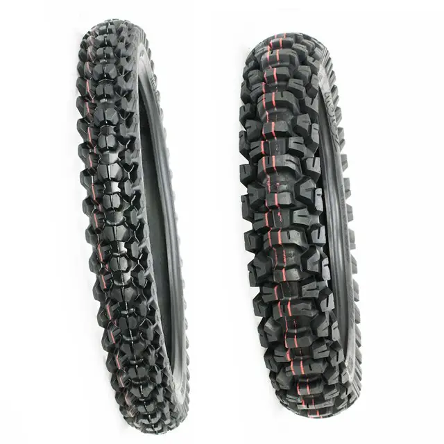

The motorcycle tires were just better all around for an Apocalypse scenario being DOT-rated and with lots of rubber. Motoz Tractionator Desert H/T
Now we have more weight issues from the tires I was going to go with fat tires, originally - still not sure of what size would be best.

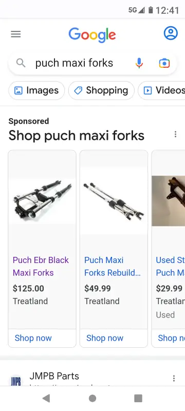

I found a set of forks as well
Fastace MTB Bike Suspension Inverted Fork 26/27.5/29 For Electric SUR RON Dirt Bike Downhill Bicycle DH Suspension Front Fork.
fair price for them tho.

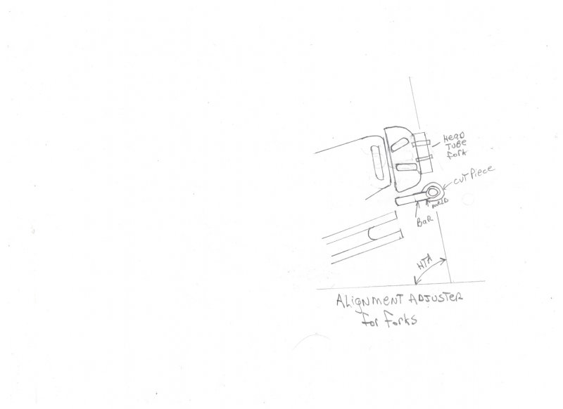

Well let's fix that notion, for the novice user without understanding, yes ok there might be some concerns. You could add some offset cam bushings that pre-articulate degree changes or rotate the busing to move small amounts for fine-tuning then tighten it down, preferred with a torque wrench.
So as a builder, I may want to move around and reset my bike's alignment from time to time as I change and adjust for stuff in R&D it may. It may not take too much to come up with some alignment methods - this is where a pen laser and tubing for holders and a yardstick/meter stick and perhaps a couple of plumb balls and some gear clamps, you could utilize a laser lever or a magnet level, or sorts, etc. or even some gun bore alignment laser as tools. Lots of creative tools as DIY for making some sort of alignment tools.

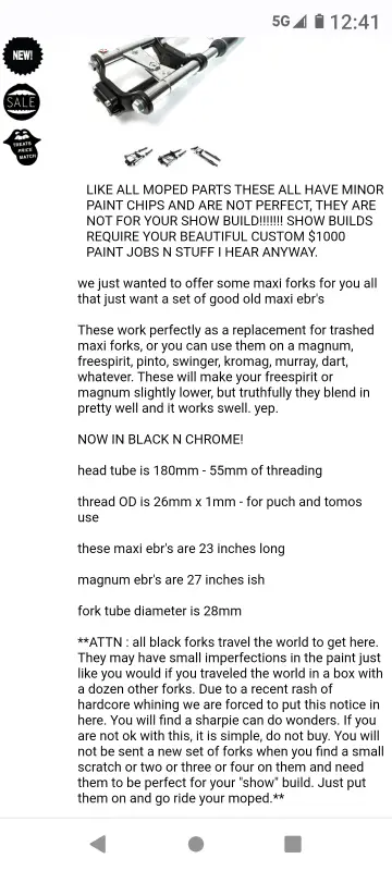

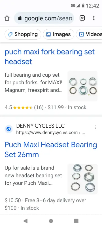

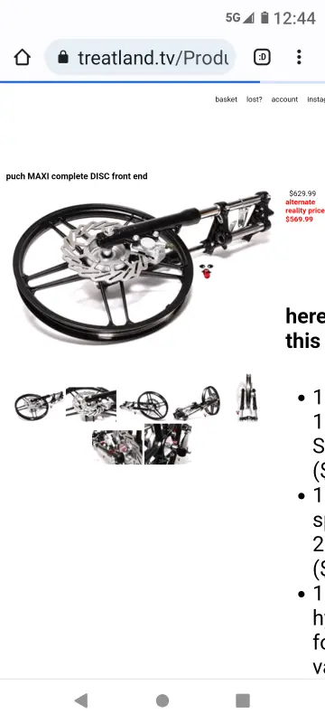

These will fit a 1" threaded 180mm steer tube for conversion to 1 1/8 Threadless would be to mix and match sets for each just measure carefully to get the right fit...
Well thank you for the site, they also have some good prices as well, I never gave mopeds much thought, Where I live we don't see much of them except really old ones. I thought of them as more mini bikes, I live up more in the boonies. I guess I need to get more often lol.
