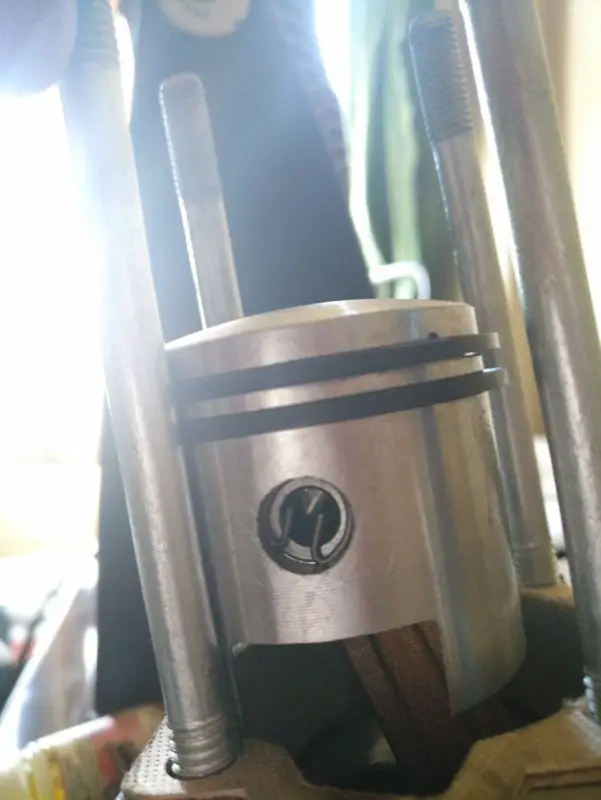

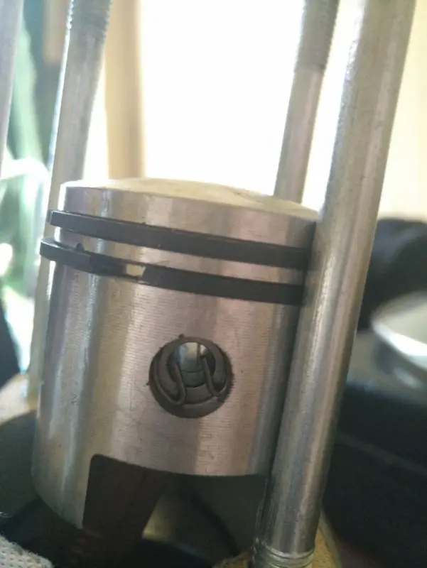

I recently bought my first kit. I know very little about engines, just what I've learned from youtube. My kit came with the head and piston not installed. I've heard that incorrect installation of the piston clips can cause the pin to edge out the clip into the motor. I was hoping for some feedback on if I've done this correctly. Thanks. :)

I wouldn't even trust those clips get some clips from Weisco
Or use a snap ring from ace hardware This is what I used

If ya did put the clip in correctly you should be able to turn it in the groove
Have the open end to the crank
Check your wrist pin and file off any sharp edges as these cut into the clip tabs causing them break off. The little broke off tab will ruin your cyl and piston
Some say the China clips are junk and pop out anyways.
Recommended is to cut the little tabs off before installing
But ya might as well buy new clips from Weisco Their Quality
