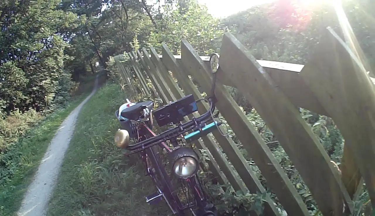

It'll take more than a fall like that to stop me yet, in years gone by I did a lot of mountain biking, also figure skating, they both kinda teach you to just get back up and try again, sometimes you just have to throw the bike and take the fall as was the case here. That and I'm used to riding around on what can likely be described as tetanus waiting to happen, the design motifs of the car in your avatar certainly remind me of the era that came from, this is my usual ride when I'm not using a motor;
That's the fancy one, that one has electric lights, the other one I have uses kerosene. Wouldn't mind finding a period correct autowheel for them some day, but as if that's ever gonna happen.
