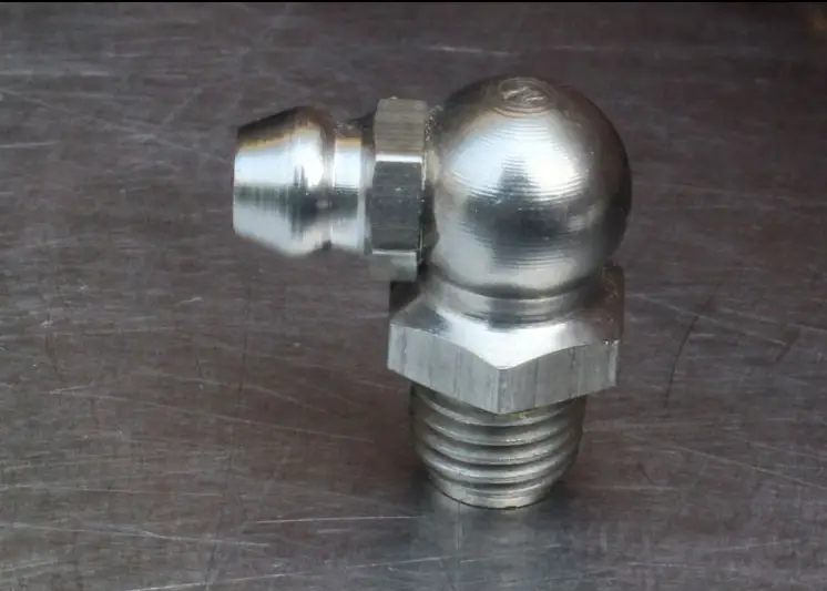

First thing you need is a 90Deg. M8x1.0 Grease Nipple
Pull the Grease nipple apart and you will be left with a M6 Female thread. At least mine was and i would think they are all the same.
The grease nipple threads into the carb very tight
, even after being stripped
Next you just need the M6 hose barb...

The female threads on the grease nipple are kinda sloppy, so your gunna need some weld bond or something to make a good strong seal.
But after that you are good to go.
You might also want some hose clips... I find 9MM is good. 10mm is to big
