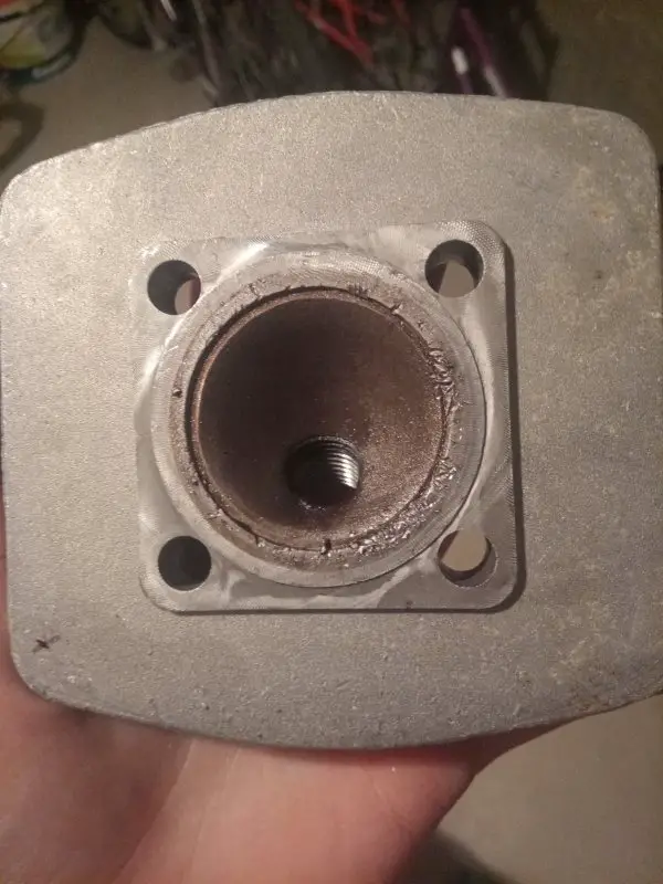

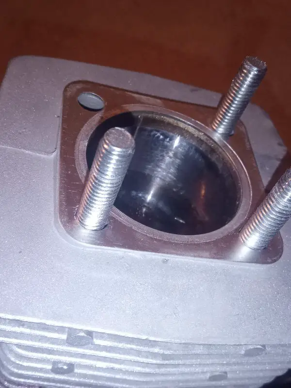

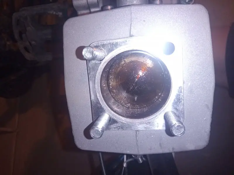

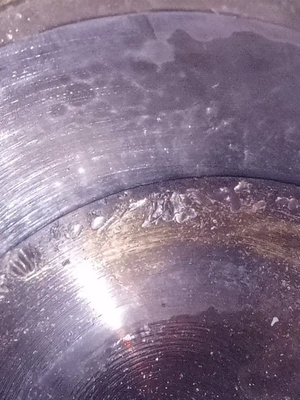

Hello, after 50km this happend...
huge power loss, And Now it wont even go.. Do i have to replace everything or Is there easier fix?

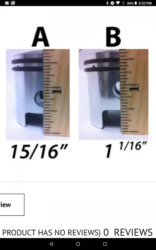

You need to pull the cylinder off and see which piston you have.

I would pull the engine off and wash out the bottom end in case some of the debris is in the crankcase, used mixed fuel to flush it out.
