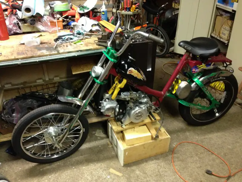

hi im planning on building a streched cruiser with a bent springer fork and a honda CRF50 engine. i would like to contact an expert at attaching these engines
brokenpedals
The CRF50 & clones are great lil powerpacks, they take some doing to get into a bicycle but the stretch chopper style is a good candidate that doesn't necessarily require a hack job - there's some examples & leads in this thread as an example: http://motorbicycling.com/showthread.php?t=19630
I dunno much about the stretched cruiser style TBH... aside from the cantilever frame it does seem to have a bit of room tho & "hanging" this motor type is defo a good way to go, I wonder if there's space enough to do something like that w/o it being too high up?
Here's an interesting take on hanging motor mount plates, unfortunately I can't find any trace of what happened w/this project;
Well i have been looking at a nother engine option a hatz 1b30 what do u think
if you mount a engine plate with u-bolts and muffler clamp saddles, the saddles will tilt/pivot to allow for the curve in the frame
I have done so with the plate I did to mount my old 49cc to my daughter's spoiler![]()
well i do like the streched cruiser but would prefer a full suspension instead. im trying to plan a simple bike with no peddles so that its easier to maintain and build. i im going to look for a compleat honda crf engine still trying to deside if 50cc 70cc or 110cc or if i should buy the complet bike and add big wheels...... or use the crf frame and extend the swing arm and add a bicycle fork and 26" tires.......
If you go with the 50cc you can change out the jug and piston later to up the cc rating to what you want. These little engines can be upgraded easily.
yea thats true. where can i buy a new compleat crf50 engine? or should i buy compleat crf50 and sell the roller frame?
