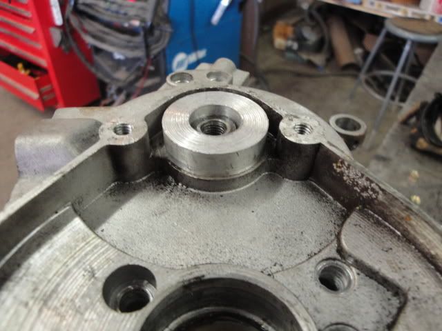

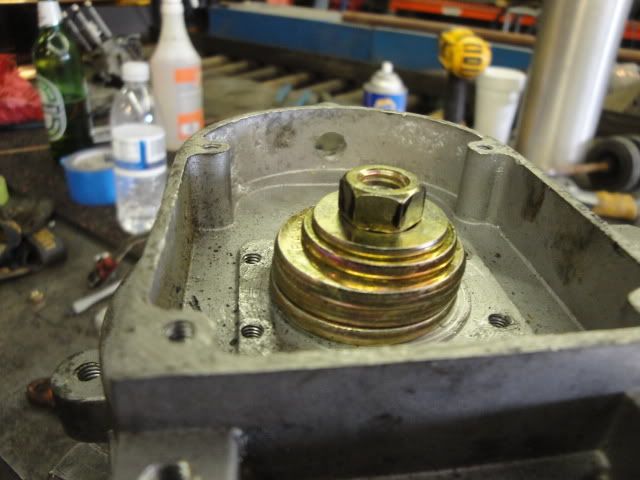

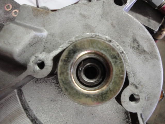

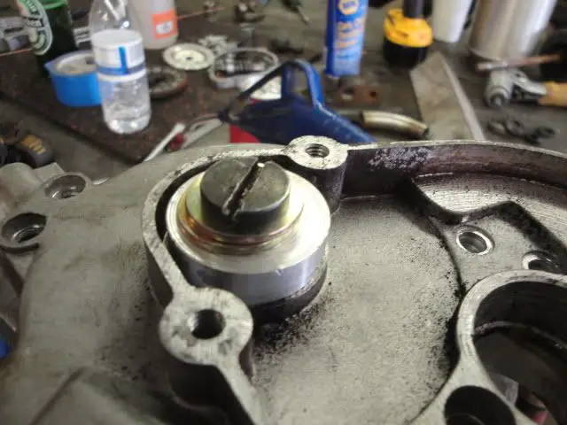

I don`t really understand whats going on in the pic.`s since there`s no explanation....I want to take this spare motor apart and clean it up,inside the cases`s,elim. some slag ,ect.ect......Replace the bearings,bolts......Wanna know what I`m up against.....
in the pic im using the nut/bolt to pull the crank snout through the washers without hammering or tapping on any parts.
