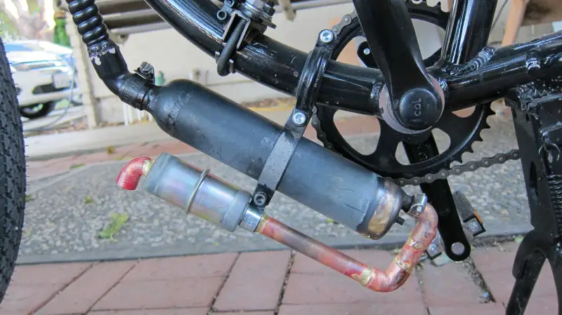

Sweet advice, thank you, that sounds perfect. the copper piping I bought was 3/4", and it fits perfectly in the exhaust. I imagine that's OD? I also imagine electrical supply shops could probably bend the conduit there. I remember going to a shop looking for tubing for my intake and they mentioned using conduit.
I have a Lincoln welder which is currently set up for flux core steel wire. I am brand new to welding, but decided to see if I could weld copper fittings to an expansion pipe I chopped up. It could be that I am horrible at welding pipe, but it wasn't easy putting down a good weld. The chrome plating on the chopped pipe was impossible to weld, but once I ground that off, I was able to get weld the copper and steel (only on the high setting of my 110V welder). Doesn't look pretty, but it might if you were good at it - I am not.
It is solid though...I messed up by welding the markings of the wrong side of the 45 union, and knew as soon as I'd done it that it was permanent. I added another elbow - 90 deg unfortunately, but waaaaay easier than trying to somehow remove the welded piece.
Be careful of welding EMT. Although I don't think it's necessarily galvanized, certain coatings cause poisonous gasses. Correct me if I'm wrong, please, but I think the zinc in galvanized steel is bad for you if you weld it.
How did you test the welds to see if they are indeed strong?
in a bunch of places I could see that the copper had melted and mixed with the steel (not a common alloy, but sure looks the part). Everywhere else was a thick weld of steel covering the joint. I applied a good bit of torque to the pipe to see if I could break the weld. No chance. We'll see how it holds up to vibration, but I'd be very surprised if it doesn't hold. I'll post something if it falls apart anytime soon.

My copper exhaust is done though and I used all adapters so no welding. I did have to abandon using the fiber high temp gasket material as it disintegrated. I made copper donuts very thin. I place 10 at each end of the place where the water pipe otherwise would have the rubber washer since rubber would melt and burn.
