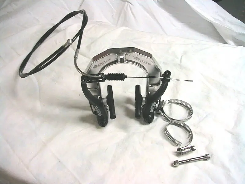

Ok, so that would rule out a band brake on one of these I guess?
I dont think a band brake is going to be any better than a coaster brake, and if you have a shimano hub, thats a pretty good coaster hub.
