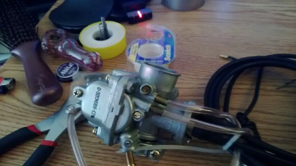

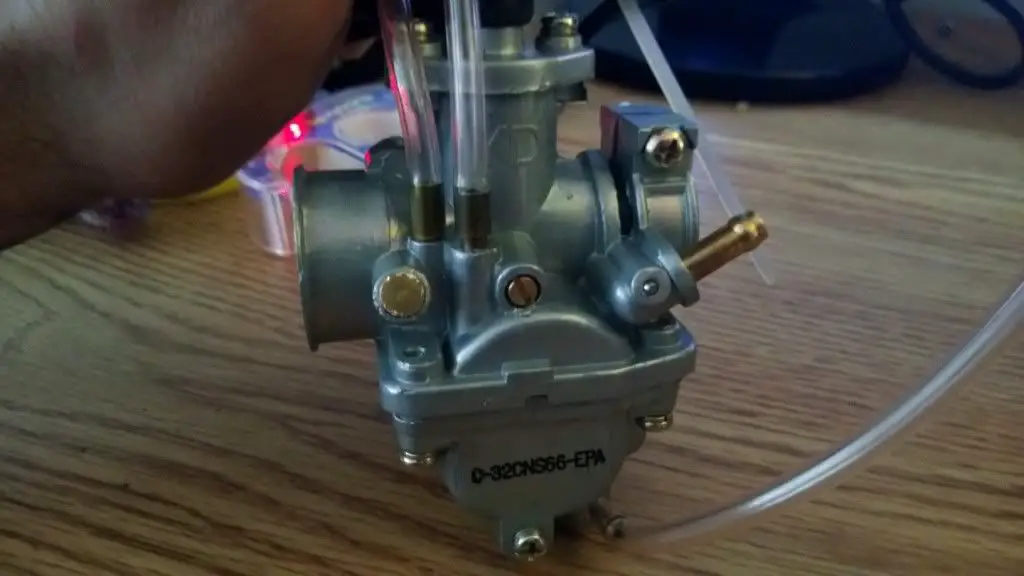

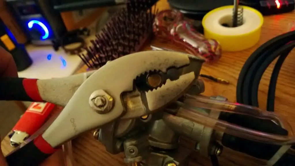

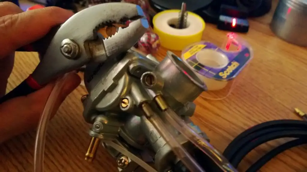

Hey guys,
I just found out my CNS V3 carb has an a/gas ratio adjustment. I took off this little brass cap and sure enough, there was a little slot there for a flathead. Does anyone know how to adjust it correctly?

Also how did you get it out. And will is slow down my bike. because my bike wont stop going over 30-40. so, I don't know what to do?
And do I need the brass? because if I can drill a whole and pull it out, I will.
