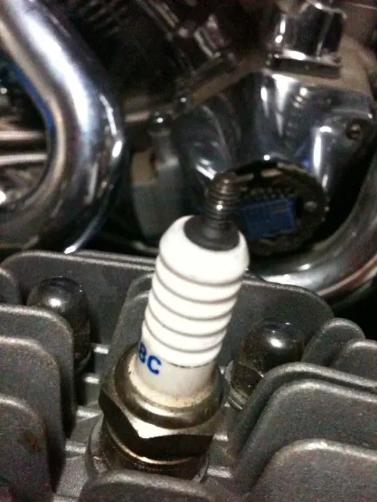

Well thank you to both of you for the help. With a combination of both of your advices and some help from the following thread ( http://motorbicycling.com/showthread.php?t=22729 I was able to get the clutch working correctly. So Thank You! I am but one step away from getting it to run! So one more quick question and hopefully by the time I get home tomorrow it will be a quick fix and a start. It doesn't have to deal with the clutch but I already have this thread so here it goes... Everything is in place and bolted tight, but the spark plug boot will not connect to the spark plug... That is all I need help with and I'm done so Please HELP!!!! I can't wait any longer!
usually the spark plug has a copper colored whatchamacallit thingamajig on the tip youll wanna remove this by gently turning it like a nut the boot will then have a positive feel when you "click" it on to the threads heres a pic of how it should look if ya already havent done this. good luck, n happy motoring. hope this helps.

Once again thank you for the help. That was exactly what I needed and now I have confirmation of a spark. Tried to get it running but it just won't fire... I have been looking at other threads and think I know what to do but don't have the time tonight... I'll post again tomorrow with results or questions but hopefully just good results. Again thanks for all of the help.
