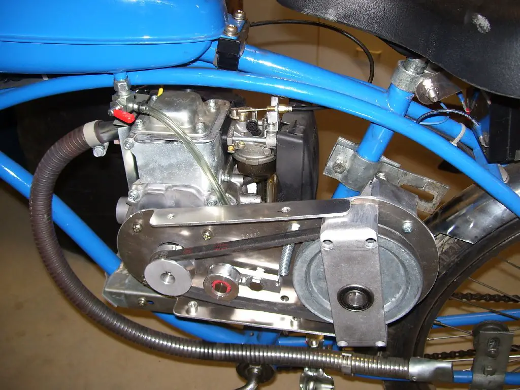

How much pressure does the clutch tension/idler pulley place on the primary belt drive in order for it to work?
Examples...
My bike is the first picture and doesn't require much pressure to apply tension to the primary belt.
In saying that I probably built my shifter/lever a little overkill and I engage/disengage the clutch via a fairly long shift lever so it may be hard for me to judge how much pressure is needed

I'm still trying to understand how your shifter/lever totally works.
Basicly, if the idler is used on the slack side of the belt, it only takes about 10 lbs or so of force. If you used it on the pulling side of the belt it would need a lot more pressure.
It's very basic actually. When I push the lever forward it tensions the primary belt and I am away, when I pull the lever back the tension on the primary goes slack and allows slippage of the primary ( like having your clutch lever in). The whole setup works surprisingly well and I've only had to make a few small adjustments as the primary belt stretched over time.
The slack side would be the bottom side of the belt as it goes back towards the rear wheel/jack shaft. Output pulley turning counter clockwise on left side and jack shaft on right side as you look at the primary drive with the idler between them below the belt like the above picture.
Is this correct?
Yeah that's correct. Whozawhats bike (bottom picture) has the jackshaft in a different position but the setup is still identical. If you turn Whozzawhats picture 90 degrees counter clockwise you will see both setup a are identical..... Hope that helps, is that what you meant???

It sure is, now I need to get my jack shaft installed and create the idler/clutch pulley setup.
No reason other that to save space and keep it inside the housing. That's not the optimal position though. The idler on the outside causes more contact of the belt with the smallish drive pulley. Prolly don't make much difference with the 49cc engine though, not a lot of torque to induce slippage anyway. Plus it's a high rpm engine that doesn't have the dramatic torsional vibration of slower turning engines. I know from experience that belt slippage and resultant belt wear from torsional vibes is an issue to contend with with the 99 and larger engines.
