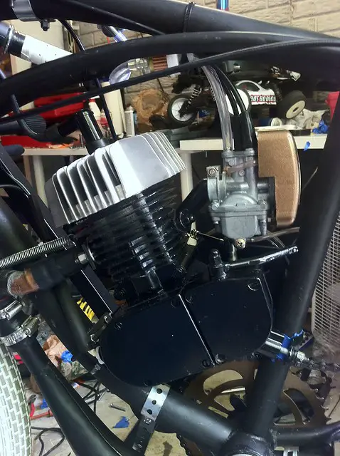

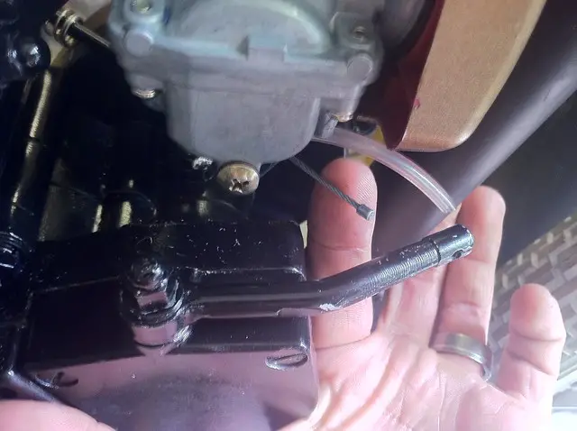

So after scratching my head and feeling that the clutch assembly just didn't seem right, I did a bit more researching and it seems to me that I was supplied the cable. Looks to be a throttle cable and it's too short. When I pull the actuator arm over to the cable, it's disengaged by about an 3/4". I actually have to apply pressure to the arm to meet the cable and there's no way to put the brass cable end on the cable. Also, notice the actuator arm isn't the typical straight unit. Anyone else have this?

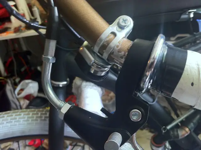

I'm guessing a new cable is in order. I removed the adjuster nut/assembly on the lever to use the one supplied on the end of the cable. Knew then it
didn't seem right.

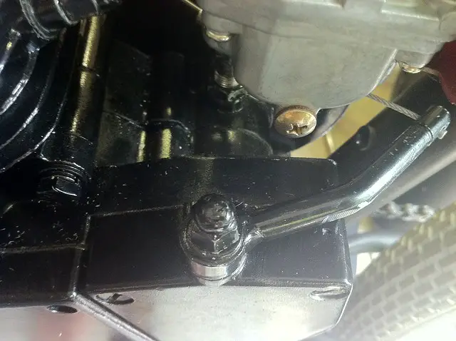

Clutch actuator arm hooked up to the cable. You can see that's actually being pulled a good 1/2"-3/4" to be able to hook to cable.

First of all that is NOT a clutch cable. There are no ends attached to the end where it pulls on the clutch arm. ChinaMart (WalMart) has a cable kit that has a long cable included in it (about $6.00) cut off the end and you will be able to slide on the adjuster clamp.
I knew it. Guess I have a back-up throttle cable set now...

That's a throttle cable. You can just use a smaller cable housing and use it though.
