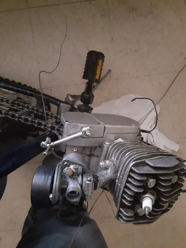

D daveet6666 Member Mar 20, 2020 #1 My clutch arm goes in way to far and its pushed in as far as it will go for rear wheel to spin anyone know how to fix this? Attachments 20200320_163455.jpg 74.7 KB · Views: 306
Greg58 Well-Known Member Mar 20, 2020 #2 Back off on the flower nut a round or two and see if it helps.
D daveet6666 Member Mar 20, 2020 #3 I tried that think i went wrong way gonna try other way thanks greg
D daveet6666 Member Mar 22, 2020 #5 Greg58 said: Lefty loosie, righty tighty. Click to expand... Thank you greg that did the trick! Appriciate you man
