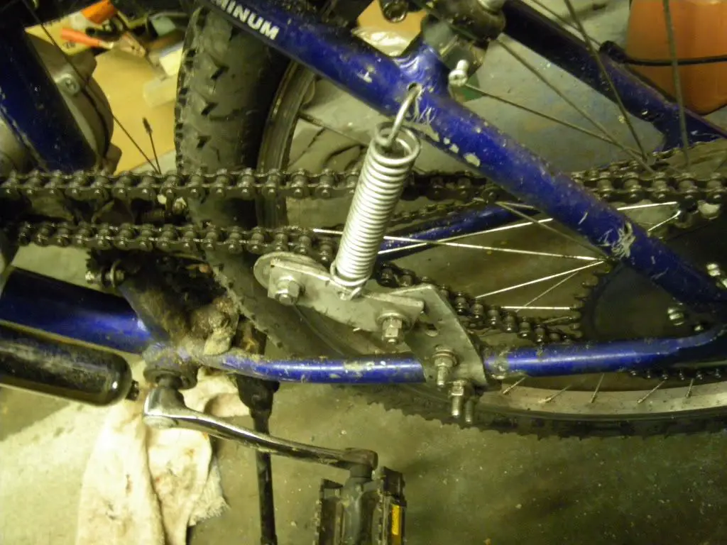

cheap spring loaded tensioner $5
Yet another chain tensioner solution. I took one idea using a piece of 1/8” x 2” x 36” aluminum flat bar from Home Depot and some gas tank clamps from NAPA coupled with a nifty “Sunlite single speed chain guide” with build-in tensioner (used to guide tandem bike chains) and put it together. The spring seems about the right tension to take out excess slack. I’m using it with a 4G T-Belt Huasheng 4 stroke, so I’m not having the “engine brake” issues. I only have about 50 miles on the set-up; however, everything looks good. I tried the Tractor Supply guide; however, it was so wide, the chain kept jumping off the sprocket – didn’t really guide it.

OK, here are the pictures showing the "Sunlite Single speed Chain Guide" and my installation. You can google Sunlite to get more details. The guide runs about $25.00.

not safe !!!!!! i had one on one of my bikes the plastic teeth broke too pieces back whee lock up at 35mph was not a good day!!!!!!!
Thanks again, Kla63 for the post. I reinstalled the Tractor Supply roller bearing chain guide and adjusted it so that it lined up with both sprockets; so far, the chain slack is taken up and the chain is tracking. I'll do a follow up post down the road noting how it is working.

haha....just want to let you know guys that the spring loaded that i made is working good now i had it for a month running at 35mph-40mph doesnt have a problem at all. the only thing is you really need to use pullstart otherwise you gonna have hard time to bump start it. and always check the tension of the spring. if it get loose cut off about 1/2inch on the spring every month.
