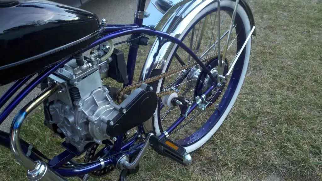

I am new here but wanted to share some pics of my tensioner. Just installed racing chain....wore out the cheap one....works great and reduces vibration, chain slap and noise....the roller is made of UHMW. Just finished my first bike.......

I recently changed the timing chain tensioner in my Chevy s10 truck. I installed the old one (not bad) on my 4 stroke bike using the original roller bracket. It is made of teflon with a steel backing that gives it flex. It already had a hole on one end, so I just bolted it right onto the bracket. It smoothed out the whole ride and the chain doesn't slap anymore. It is totally adjustable and should last a long time. It doesn't guide the chain at all, so the front and rear sprocket does have to be aligned pretty well on its own. It should be anyway. That's the hardest part of the whole motorized bike build.

Hey Mrfixxit,
what did you use for the tensioner bracket? Looks like it used to be 2 "tear drop" shaped pieces and you cut one in half.
That bike is sweet! Love the chrome fenders and the drum brake on the rear wheel. Does it have a drum on the front as well?
One last question, where did you get that engine? was it a kit? (okay, 2 last questions...)
Tensioner bracked custom made and welded to frame before powder coating....front hub is also 90mm drum brake.....awesome stopping power. Engine is honda 49cc chinese copy.....looks like OEM honda comparing mill marks. Had gearing modified 4 to 1 and strengthened at drive sprocket....recently installed new carburetor and K&N filter.....
